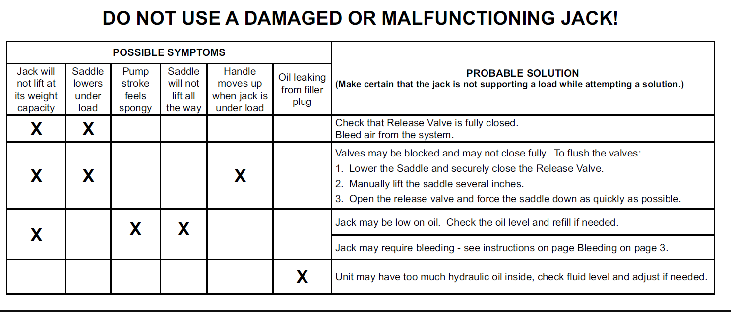

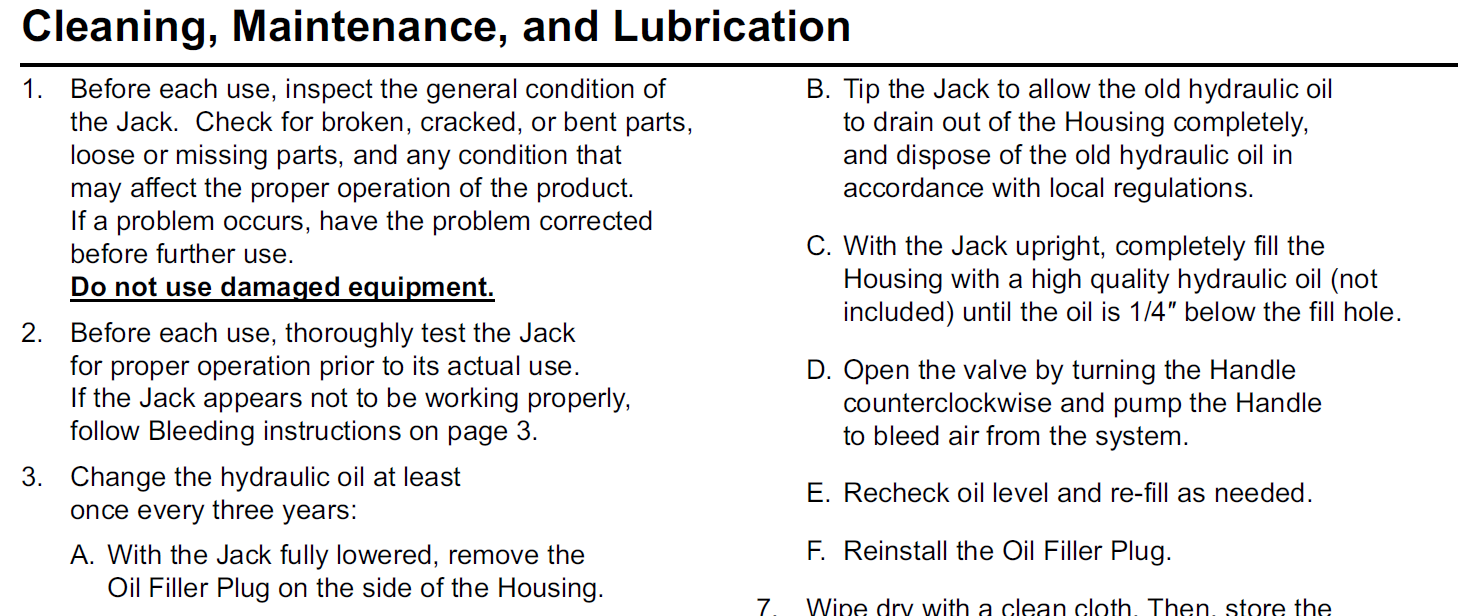

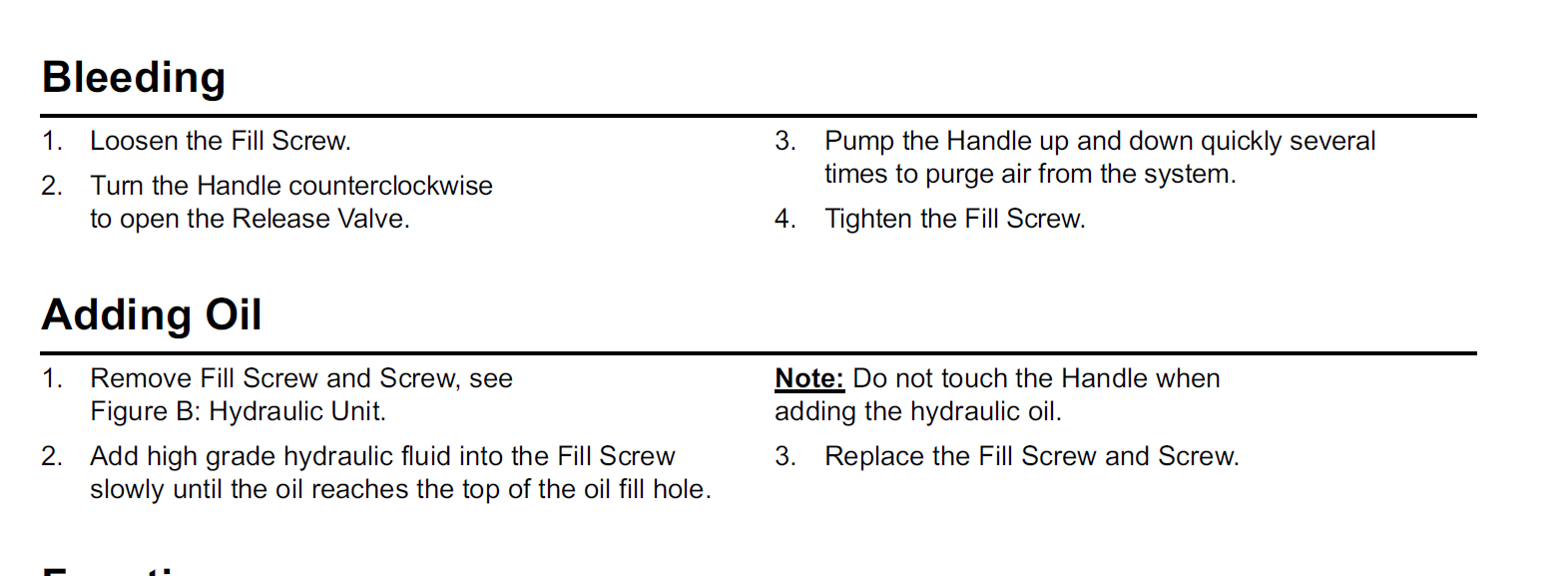

I just happened to run across this thread and even though it's old I thought I'd answer. The problem I've had with my floor jacks has been solved with bleeding and/or adding hydraulic fluid (or changing it completely). I have a couple of Pittsburgh Racing (Harbor Freight) Low-Profile jacks that I've brought back to 100% using the maint notes below.
Floor jack bleeding & adding hydraulic fluid screenshot 2023-04-16.png (68.13 KiB) Viewed 739 times
Floor jack maint screenshot 2023-04-16.png (146.02 KiB) Viewed 739 times
Floor jack troubleshooting screenshot 2023-04-16.png (97.51 KiB) Viewed 739 times
