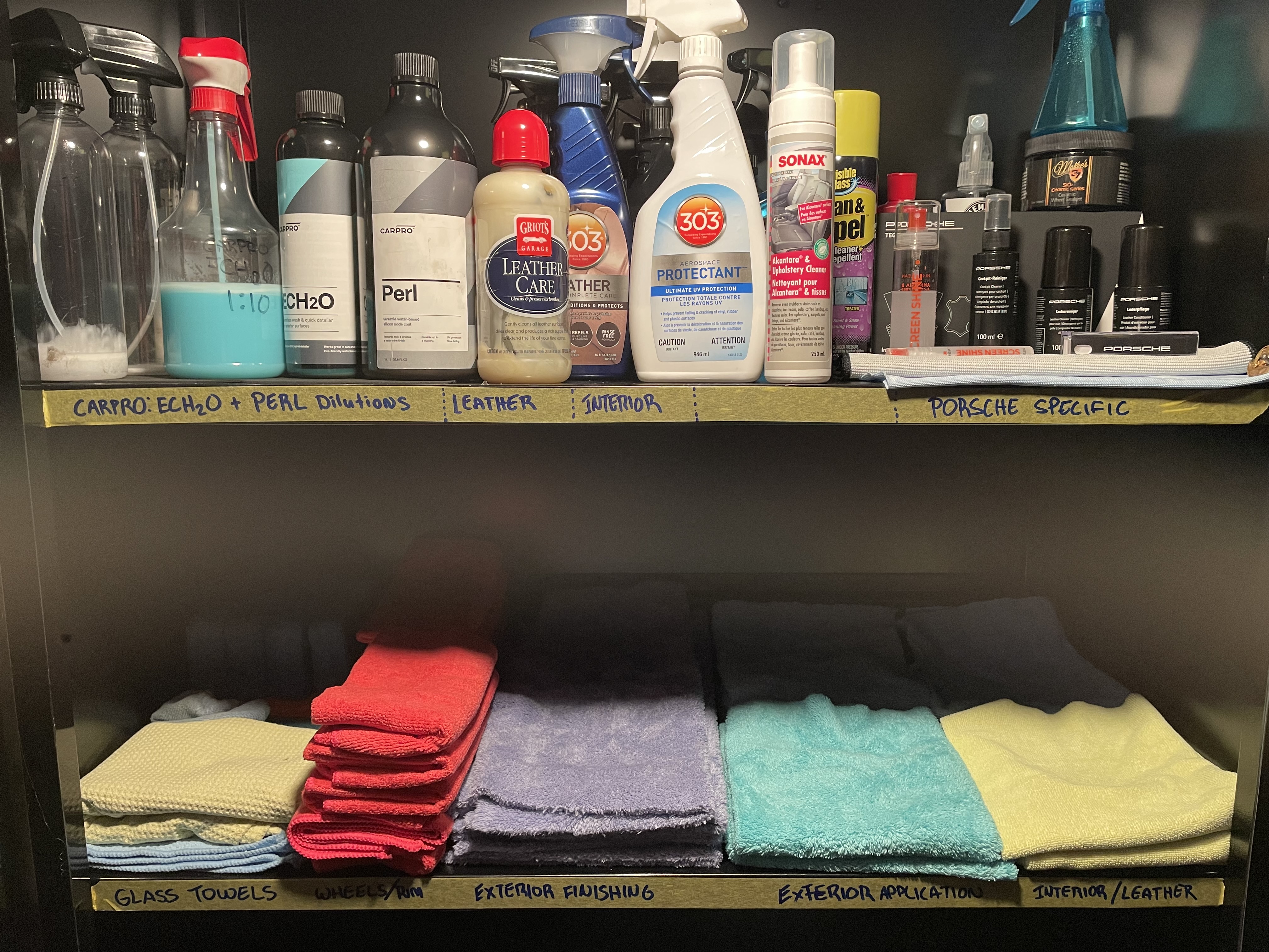

by 71eh
How new is this car? It its new'ish, don't wax!
Ideally, you would have a ceramic coating on it. If not, then I would think about getting one. It makes washing a breeze and looks like it was just waxed everytime at a fraction of the time.
If no ceramic coating (and if the car is relatively new), I would just use a good hydrophobic quick detailer. (Griots and Carpro have the best). CARPRO ECH2O Waterless & QD Concentrate 500ml (17oz) or Griots quick detailer are the best and easy to use.
1) Wash your car with a pH neutral car wash (no hybrid soaps with wax or anything) and try to use the 2 bucket method for safety.
2) Use a large drying towel to get the bulk of the water off. Youtube how to dry a car with big towel. Don't use pressure.
3) spray sections of the car with a quick detailer. Use a fresh microfiber towel to just gently smear it around with the left over water still on the car.
4) Wait a minute or two, and use a different microfiber towel to buff out the quick detailer. Done!
This is the best method I have found. I would not wax unless you are 100% confident in waxing. But I would suggest getting a ceramic coating done.
If you insist on waxing/polishing, I would watch a couple youtube videos. It can save you hours ha.
Leather: Get your own applicator pads on amazon. Rub the leather care into the pad with your fingers so there is no big globs of it. Don't buff or swirl it. Just gently wipe up and down evenly. Do sections of the seat at a time. Buff clean with a new microfiber towel.
The kit you get from Porsche (like in your pictures) is great, but it's not for everyone. The towels they give you are not that great. The leather products are good, but not the best. Test them out, see how you like them. You should not need to use the leather products on newish leather. I use 303 Leather all in one for weekly leather cleaning (just because I love detailing my cars). The Porsche products are for aged leather to bring back a shine to them. But if you have a new porsche, you should not need that. Plus, most people prefer a "from the factory" look to their leather, and not leather with a greasy shine to them.
The Porsche Interior cockpit spray or whatever its called is actually the best! It evaporates and does not leave anything behind. It's quite good.
Towels I use for various jobs:
Bulk Drying: on Amazon: The Rag Company - The Gauntlet Drying Towel (2-Pack) 70/30 Blend Korean Microfiber, Designed for Quick Absorption - 900gsm, 15in x 24in, Ice Grey + Grey
End Drying/Buffing: Meaning, after you get the bulk of water off, use these to buff it to a shine: The Rag Company - Eagle Edgeless 350 (5-Pack) Professional Korean 70/30 Blend Super Plush Microfiber Detailing Towels, 350GSM, 16in x 16in, Lavender
Great towels for interior: The Rag Company - Edgeless 300 - Microfiber Detailing Towels, Perfect for Removing Polishes
EDIT: What "ram_g" said is quite important. If I ever drop a microfiber towel on the ground. I quickly pick it up, and throw it in the trash. $4.00 towel is not worth risk of a giant scratch along your car. Unfortunately, I have seen it happen before.
