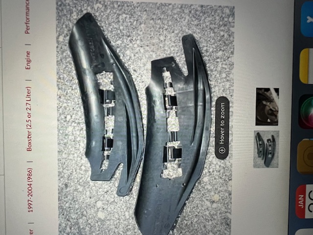

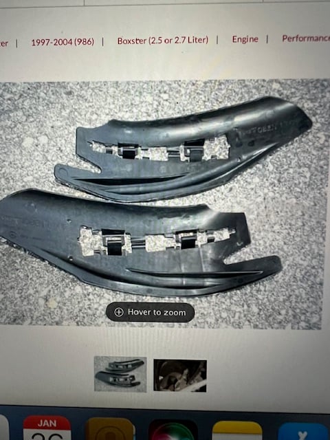

I have noticed with many aftermarket companies of Dealers the GT3 brake air deflectors are noted as a cheap improvement to get more air to the rotors/calipers on a Cayman or Boxster. They seem to never note they are a simple clip on like for a 987 , making one wonder if they are as adaptable for the 718s? I know how hard I am on brakes and I have done duct work or found aftermarket brake ducting plates ( for other makes ) to grab more air for the brakes. I would love to find a company making a bigger air scoop for the rotors, yet all I have found is the GT3 units ( slightly bigger ) or the GT2 ones. I won't be out much money to get the GT3 ones, but just wondering what others may have done who are aggressive on the track , doing Time Trials , or even Porsche Club Racing? Please note I do not want to cut anything, so I am not willing to do actual duct work using hoses, etc.

Are you speaking of the deflectors that clip on to the front latteral arm? I have a set of GT3 ducts on my parts bin from another project, I can compare them to what is on my GTS.
Just to be sure, can you post a link to an example of what you are talking about?

Thanks J-Dub as they likely will fit and yet notes don't show them working on 718s. I know they are only a little bit larger to direct more air to the front rotors , but they are so cheap I figure every little bit helps. Thanks on the rear ducting for a GT4 that does not carry over to the GTS, as I had noticed that and that part may be on my list for the future also.
- IMG_0715.jpg (185 KiB) Viewed 5374 times

I ordered the GT3 brake air deflectors but I had the GTS in the air on Wednesday AM and it looks like the new GTS brake ducts are much larger than the older GT3 ones. Next time I have a chance to see a GT4 in the air I will see if the GTS might have the same units. I know I won't be switching them after all and my GT3 pair will be for sale once I get them in from Parts. I special ordered them so I can't expect the Store to eat them, as they are not something they normally carry. I will say I was pleased to see the deflectors are quite large and seem to really be designed to get plenty of air to the rotors/pads/calipers.
