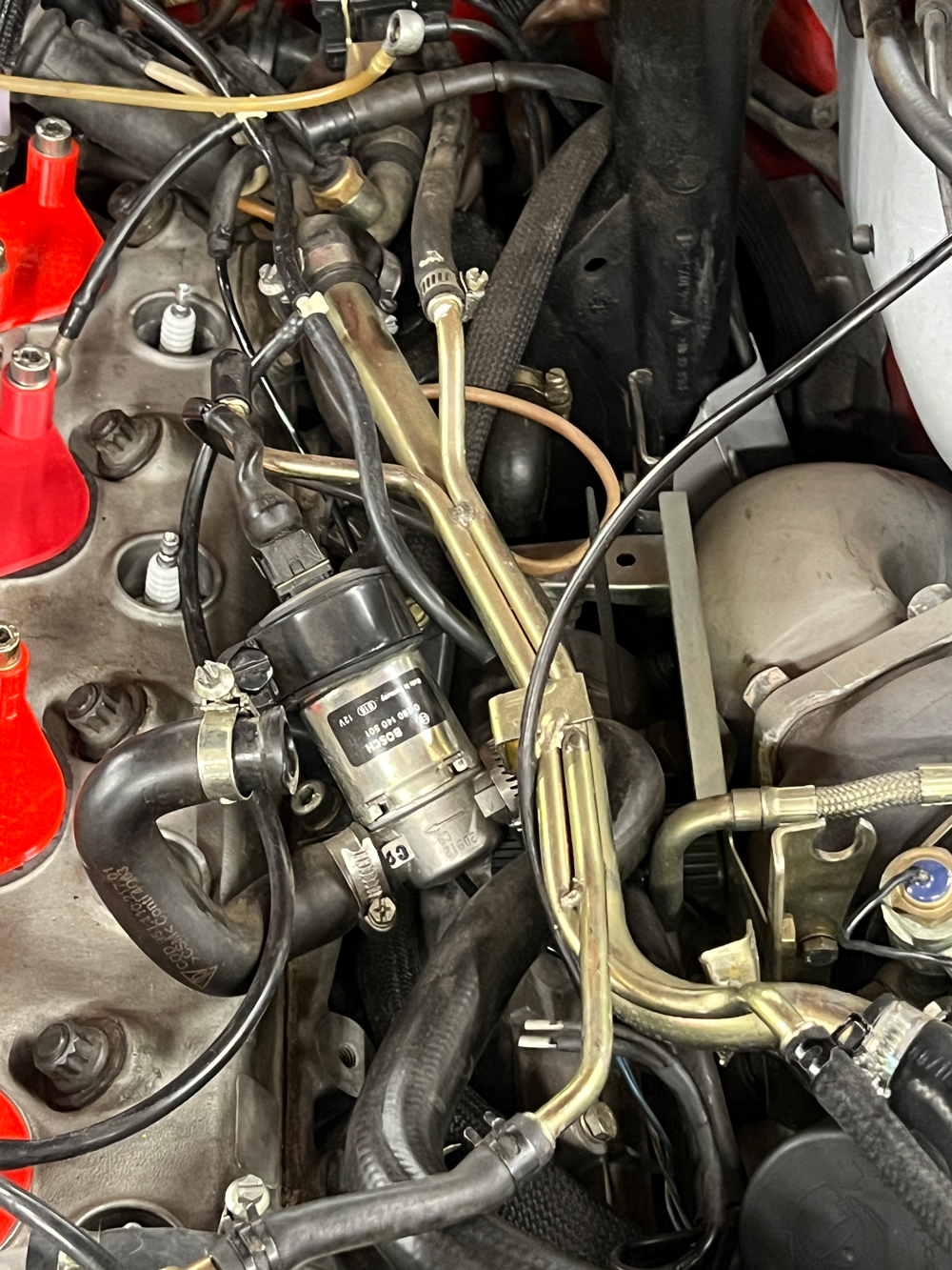

Yes starting too. I was trying to see hose orientation off the valve and which ones went were. You have more metal lines then mine does.
Re: pics of vacuum line routing
Posted: Sun Jun 08, 2025 2:13 pm
seiplej wrote: Sun Jun 08, 2025 1:38 pm Yes starting too. I was trying to see hose orientation off the valve and which ones went were. You have more metal lines then mine does.
The 3-pipe manifold varied a little bit among the 951 years, but they all have one that looks basically the same. Do you not? Maybe post a pic so we can see what you're up against?

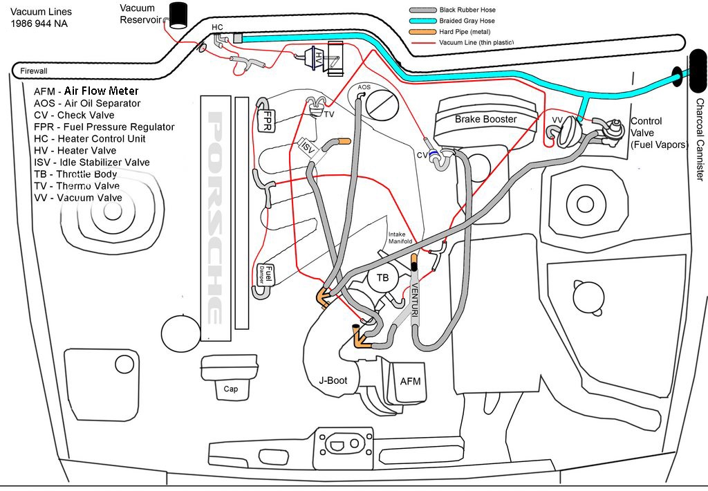

Reference Post," My new 944 and it's issues. Page 5 Vacuum line routing diagram

Here is a pic. I know the long tube ends up at the booster with the check valve but my configuration of it is a mess. Lol

Oh, my bad, I was thinking turbo. Here's the diagram Stoneguy mentioned....
