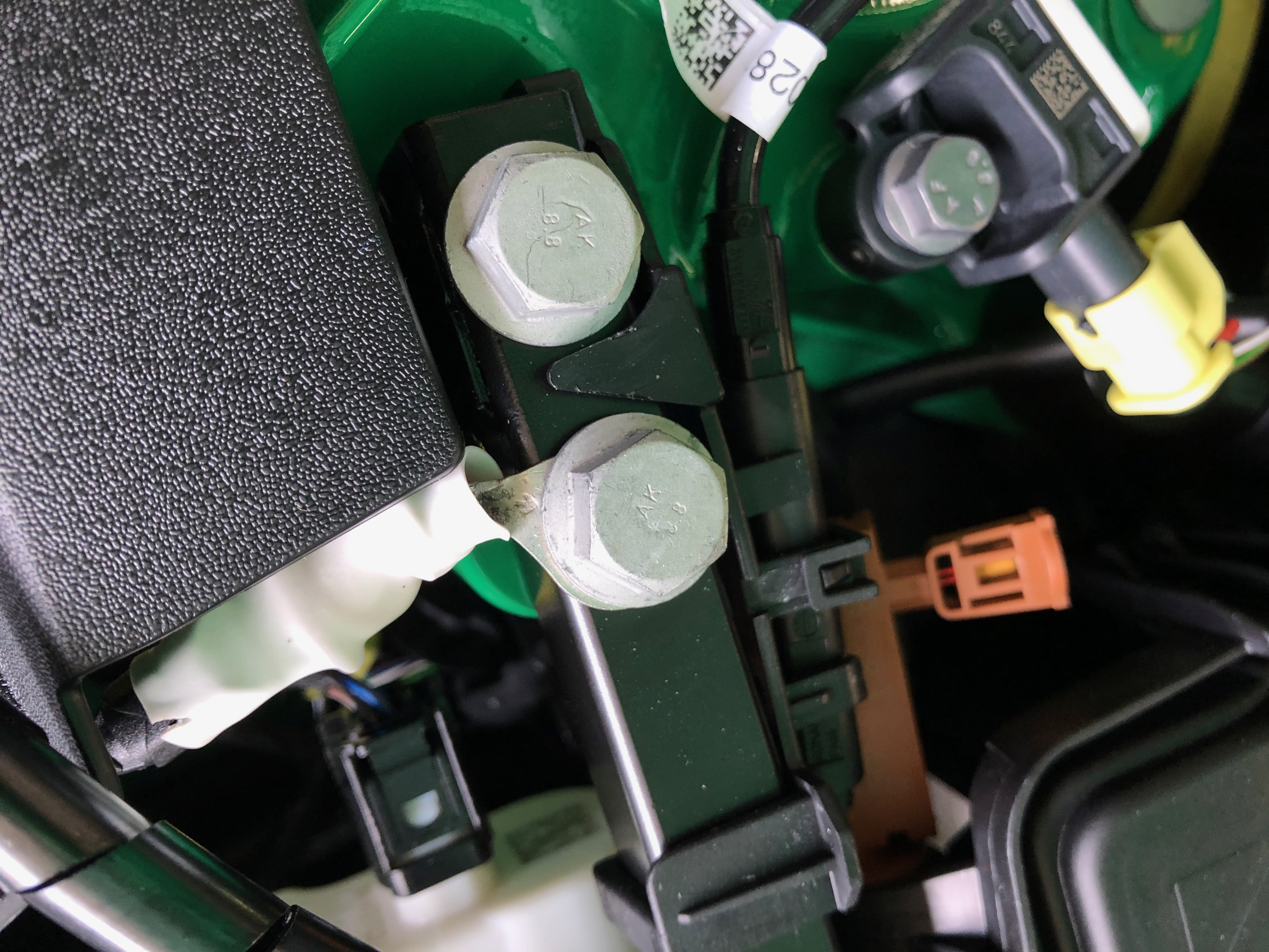

With my 992 I had no issue with the Porsche Charge-o-mat connected directly to the battery. Make sure you use the grounding point near the battery and not the negative post on the battery for your ground.StuW wrote: Sat Mar 05, 2022 7:55 am Have a battery tender from Porsche. It comes with a connector to the 12 V outlet but as many of you know (and it took me a few tries to figure this out because the Manual doesn't tell you), with the 992, the outlet shuts off 30 minutes after the car is off. So you have to have clamps and connect the tender directly to the battery. I did this and it works for several hours, it goes to full charge, then the on/off power lights start to blink, indicating an issue. The troubleshooting portion of the Manuel doesn't help. Any suggestions?

I agree with Hawk about the connection being a possible culprit. Next time it starts to blink, I'd try adjusting the clamps to make sure they have a good bite on the positive battery terminal and the designated ground post; and make sure the cigarette lighter connection joint is secure as those things were never really designed to be used as a power coupler like this....
There's a picture of the ground post in this thread if helpful:
viewtopic.php?f=14&t=60

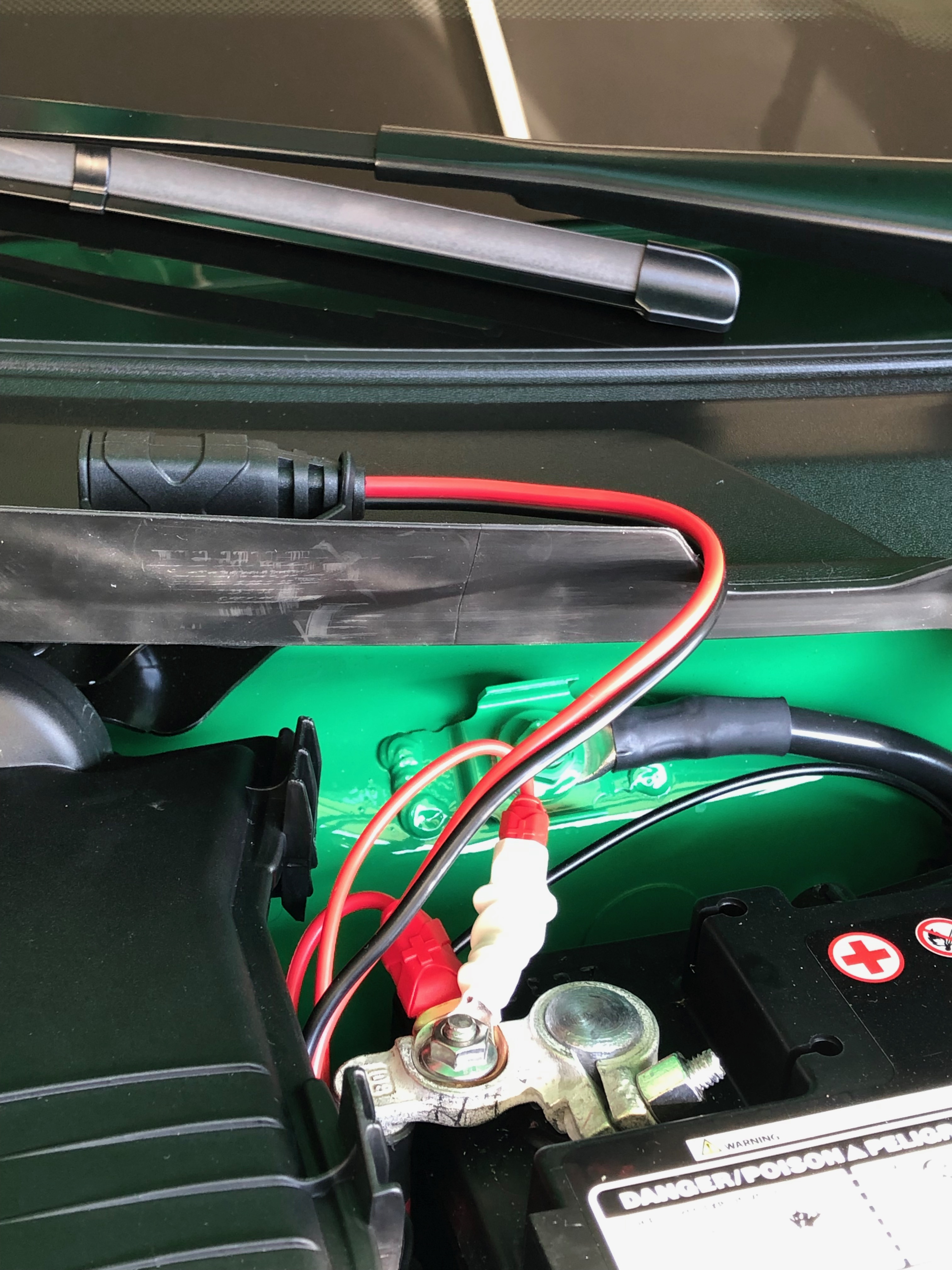

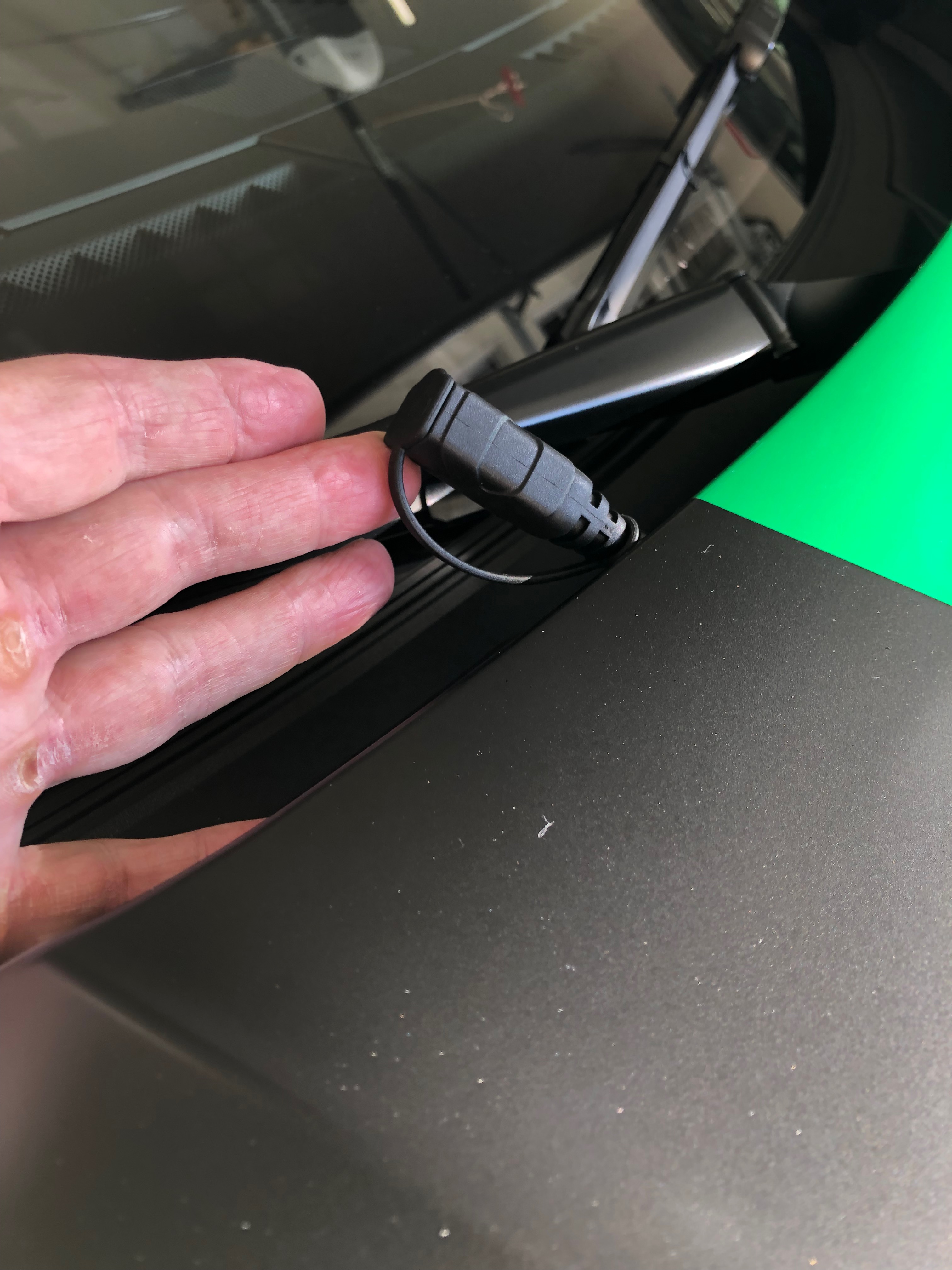

I read pages and pages of posts on how to charge the Porsche battery.
We've had auto batteries and chargers since around 1920 - over a hundred years.
Not much has changed (Lithium batteries excluded) in that time and the procedure for keeping a lead acid or AGM battery charged is not rocket science.
My car has the AGM battery and I am using the NOCO Genius trickle charger with pigtails directly connected to the positive battery terminal and a grounded bolt, adjacent to the battery.
The pigtail is accessible by the windshield even when the frunk lid is closed, avoiding the issue of accessing the fuse box if the battery completely dies.
If I had a lithium battery I would use the same procedure.
I have a BMW at my vacation home which is on a trickle charger 9 months of the year and it has started fine using this method for the past 8 years. In fact the trickle charger I use on the BMW is a Harbor Freight $10 "special".
https://www.amazon.com/dp/B07W8KJH44?pd ... 1a2e078054
- IMG_1064.jpeg (1.35 MiB) Viewed 6283 times
- IMG_1061.jpeg (1.59 MiB) Viewed 6283 times
- IMG_0878.jpeg (2.48 MiB) Viewed 6283 times

The issue with the 992 is really the lighter sockets that turn themselves off, not so much the tender or batteries (which, as you say, aren't that different from my old Firebird). I have that same quick-connect plug on my 951 and 450SL and love it -- makes it sooo much easier. I tried to install one on the 992, and couldn't get the wires on without more surgery than I was willing to undertake that day. I can't remember the exact issue, but the nut on the positive terminal was trapped in place if I recall. I'm sure with a little effort that's the way to go however. In the meantime, I've vowed to just drive the car more.
