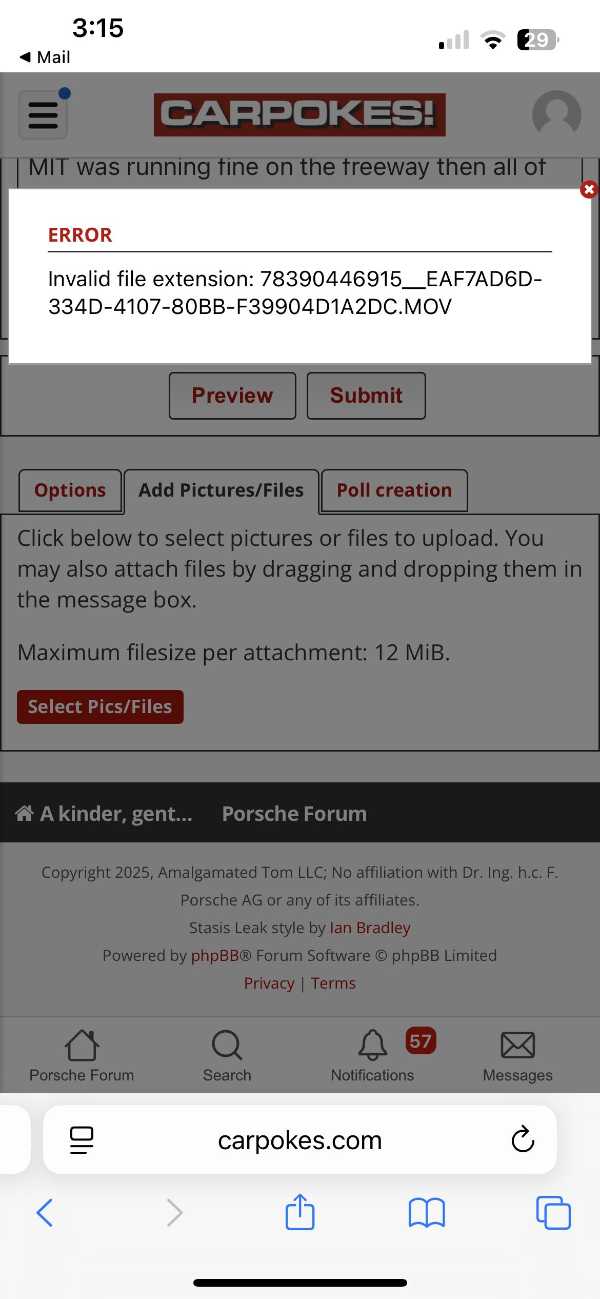

Anyone have an idea.it was running fine on the freeway then all of sudden it just stalled and died. Manage to get it started but it keeps stalling and dying
Hmm. Can’t add video.

For videos, the best way is to upload to Youtube and post the link here -- it will embed and play within the thread. You can set it to unlisted if you don't want it indexed on Youtube.
