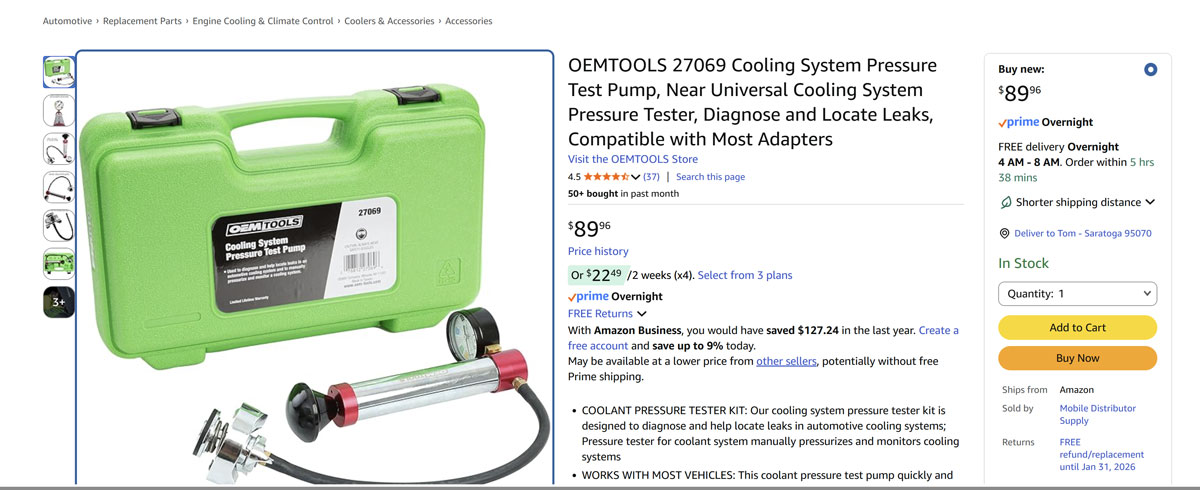

Chances are you have a tiny external leak that just steams out coolant without ever dripping. I second (third?) the pressure test suggestions. Pump up the system to 10-14psi and let it sit 15 minutes or more. If you get drops, you can then work backwards to find the source. Truly no better way to find sneaky leaks. If you get no drops anywhere (and don't have damp carpet or the smell of coolant in the cabin), then consider the possibility of mixing from the oil filter console or head gasket. Look for mocha sludge in the oil cap, oily crud in the coolant reservoir, unexplained high oil level, streaky oil when drained, coolant overflow after hard driving, one or two steam-cleaned spark plugs, etc.
But hopefully it's just a sneaky leak. I used a pressure with an inflatable bladder for years, but after it failed beyond all patch jobs, I stumbled on to this one, OEMTOOLS 27069. It fits right on the 944 reservoir and comes in a nice compact case without all the endless/unneeded adapters in the other kits. The bonus of this one is that it seals below the overflow port, so you don't need to pinch off the overflow tube. If you own a 944, a good pressure tester is a must-have tool. :)
