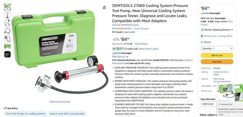

For years I used the kind with the inflatable bladder that goes into the neck of the coolant reservoir. You need to clamp off the overflow hose with that style and the bladders eventually fail. Recently, I got this one (OEM Tools 27069) and can vouch for it working well on my turbo (so presumably on an n/a too), with no need to clamp the overflow line.
