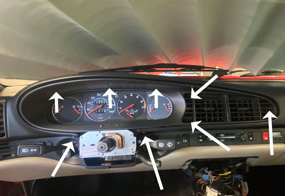

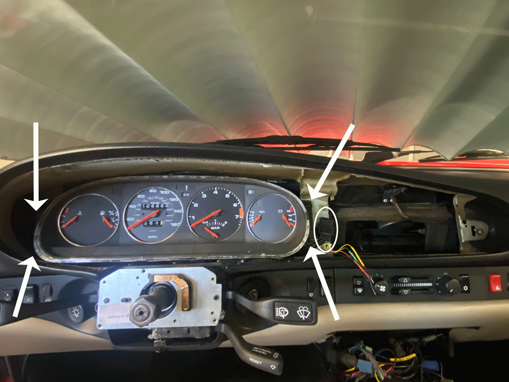

I don't really know what tab your tech is hung up on. There shouldn't be any tab? Maybe a picture would help us understand. With the steering wheel off, he just needs to remove the big black vent trim surround the cluster, the 4 screws holding the cluster in place, and the three edge connectors behind the cluster. That should be it, unless the 968 has something else this 944 guy isn't familiar with?
