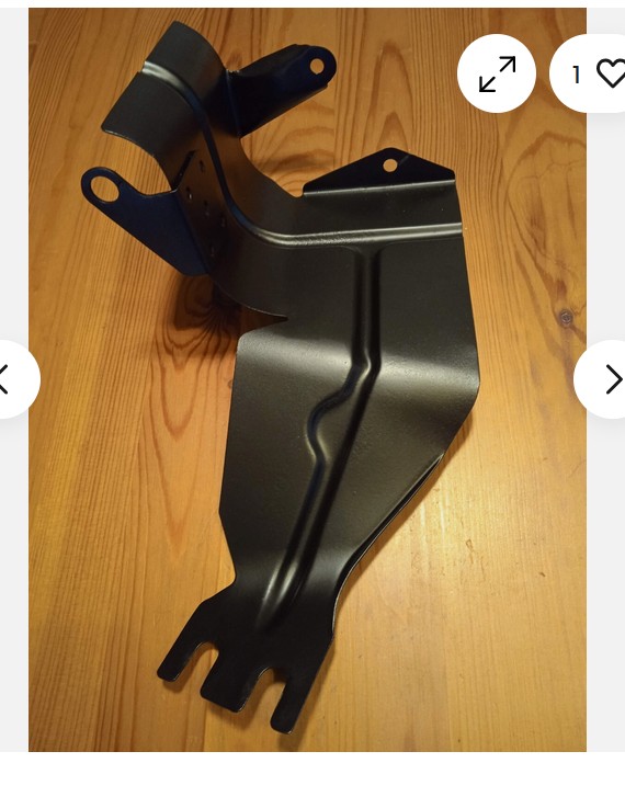

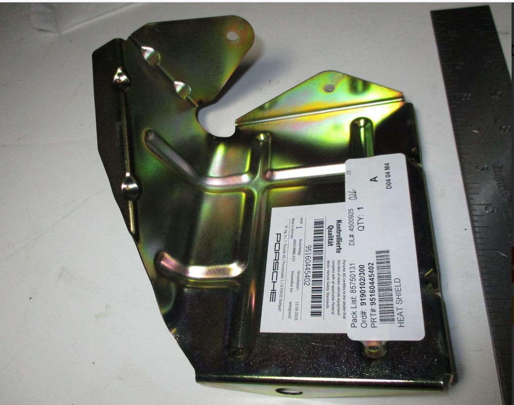

I did some reading about starter removal and thought I was prepared. Apparently there is an early vs late starter heat shield attached to the starter. The early shield must be removed before you can remove the starter from the car. The shield is a little tricky to remove because there is a bolt ABOVE the starter. The later version is much easier, though.
I don't recall reading much about early vs late starter heat shields, so mentioning it here.
I think I will get a later style shield for my 87 to make removal / installation easier going forward.
Old Style vs New Style
Old Style
Old Style
orig heat sheild 951.jpg (79.47 KiB) Viewed 367 times
New Style
New Style
new style heat shield starter.jpg (169.41 KiB) Viewed 367 times

Hi Tom, Thanks for letting me know about that. I removed my 87 starter today. This was possible by doing some mild bending and persuasion of the heat shield which was still attached to the torque tube.
What is the "proper" Porsche procedure for removing the 86 and 87 starters? Does Porsche really want you to unbolt one of the torque tube bolts to remove the heat shield prior to removing the starter?

The early version has five mounting bolts: two on the rear of the starter, one on the Torque Tube, and two on the bellhousing. The later has three: the same two on the rear of the starter and the third is one of the main starter mounting bolts.
