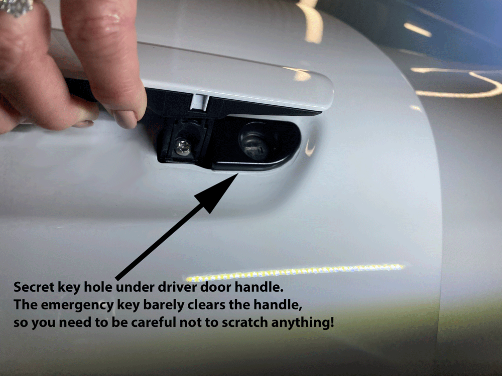

At least for the cabin, the 992 has the hidden keyhole under the door handle. Does the 718 not have that? (See pic from my DIY article below.) Or are you talking about getting in the frunk if the mechanism has power and still doesn't work? I have not confirmed for the 992 or 718, but for the last several generations of the 911, there is an emergency release cable you can access behind the front wheel liner.

‘Just checked my 2022 718. It looks like the door handle has a secret key hole like the 992

Yes, the 718 has key access to the cabin under the door handle. I’m talking about an electronic lock failure of either the frunk or trunk, not a dead battery. I believe there are cables behind a wheel liner, but haven’t confirmed. Just one of those things you’d like to know if the worst case scenario ever presents itself.
