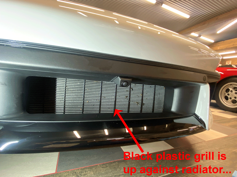

p.s., since posting this question, I discovered there is a chicken-wire like screen directly in front of the radiators, in black, which I totally missed the first few times I looked. Fairly thin metal, square mesh, easy to miss. I'll try to take a picture this afternoon. Not sure how much good they do, but certainly better than nothing.

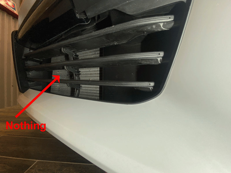

So on my car (992 turbo s), the center radiator has a plastic screen up against the radiator. Not at all sure how much it would help if a rock bounced in there, but I guess better than nothing.... The side radiators have no protection at all, other than the big decorative grills in the bumper...
