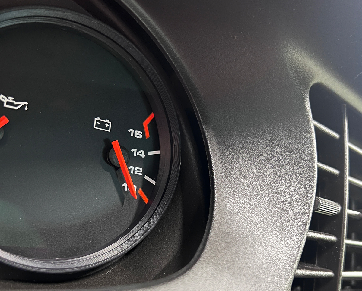

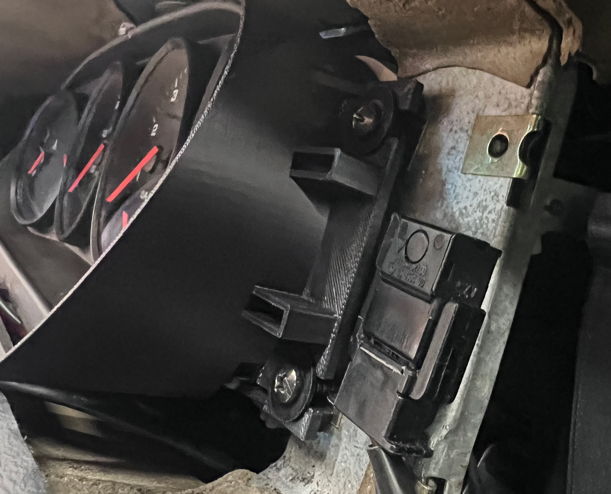

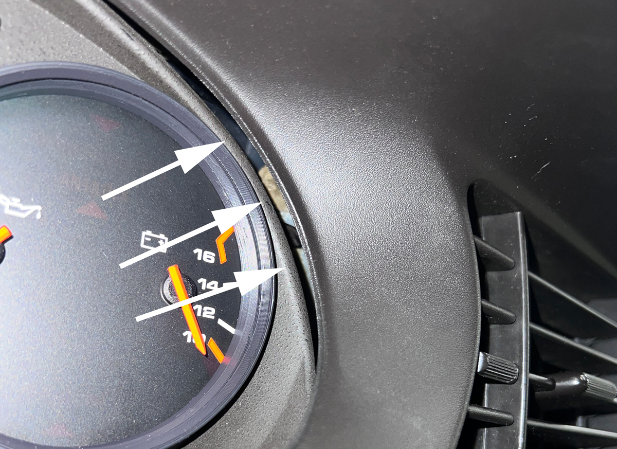

Apologies this project has taken so long, but lots of intervening life events and a little perfectionism have gotten in my way. Re the latter, after installing these gauges in my own car, I realized if you position yourself just right, you can see a gap between the instrument cluster and the trim around it, which exposed some of the hardware below. It took me weeks to notice, but once I noticed it I wanted to fix it. And why put a piece of black felt back there when you can spend days over-engineering a custom trim piece. See below. Inching ever closer and still looking for folks to try these out before the LED kit is ready.

HI @Tom
Just wondering if this gap part would need to be reversed for RHD cars?

Great question. For whatever reason, the side of the cluster near the center of the car has much more of a gap. I could print you the mirror image of this piece, which I suspect would work. Is your instrument cluster the same as a left hand drive car?Cyberpunky wrote: Sun Aug 27, 2023 7:53 pm HI @Tom
