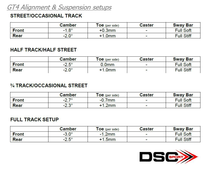

Don't know if this will help but, per recommendations from trusted sources for track setup 4+ years ago, I have mine adjusted Full Soft for front and Full Stiff for rear. It works very well for me. (The factory default setup is Middle for both front and rear.)J-Dub wrote: Sun Mar 09, 2025 6:40 pm Swapped my GTS anti-sway bars for GT4 spec anti-sway bars this weekend. I don't yet know how much of an improvement they are, need to drive the car a bit more still. The rear bar was really quite similar and the front bar is quite substantially thicker on the Gt4. I now have three holes front and rear to be able to fine tune the ratio front to rear.
This GT4 setup chart and/or the attached PDF doc from DSC Sport/TPC Racing that I found later confirmed the sway settings. (Note that I have not followed DSC/TPC's alignment specs precisely although theirs are certainly in the correct ballpark and would be a good place to start.)

Interesting graph and thanks for posting as my GTS is in the shop getting wheel studs and GT3 front arms as we speak. I doubt I can get -3 degrees up front though as the GTS is more limited with camber adjustments.
