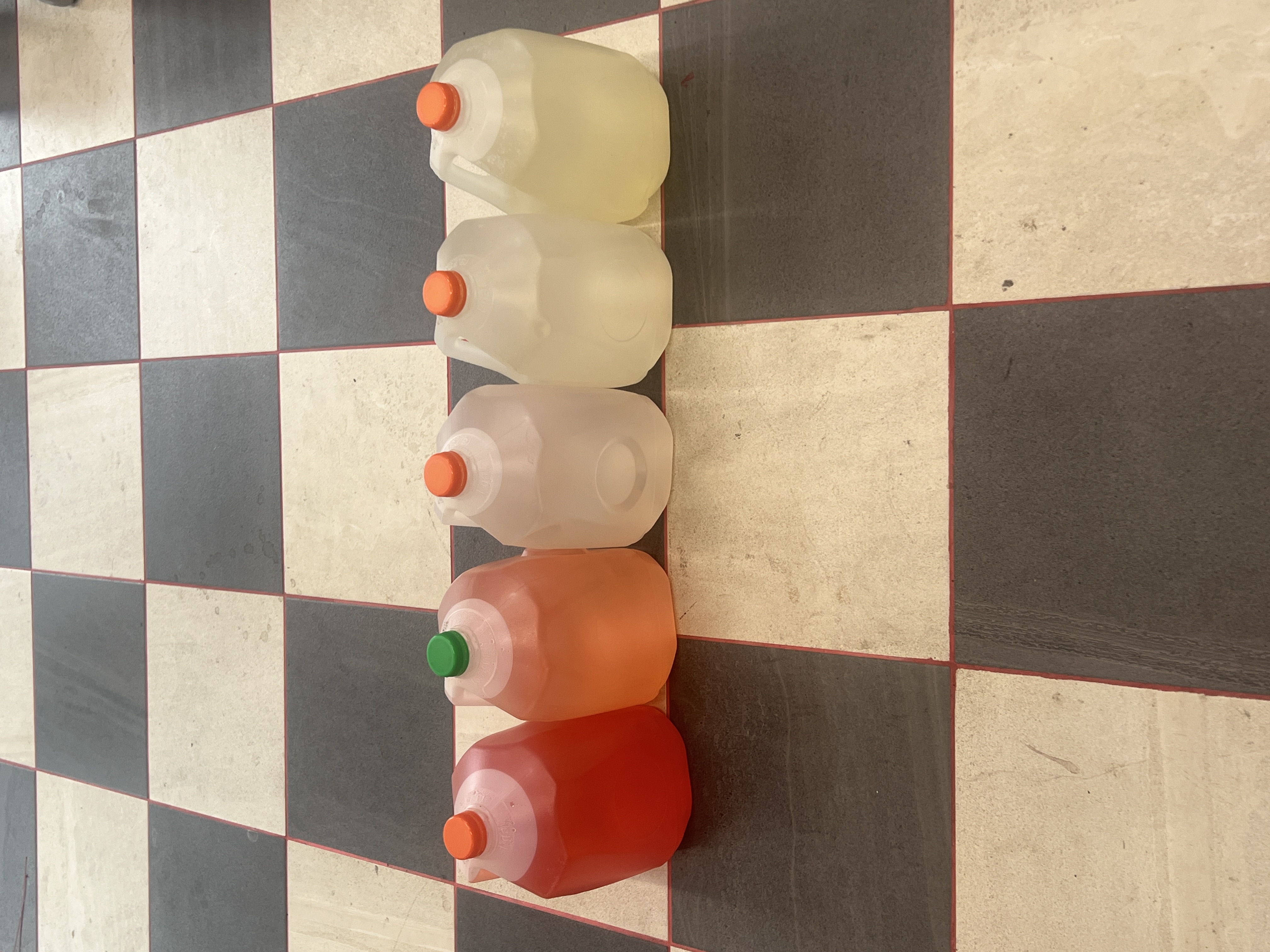

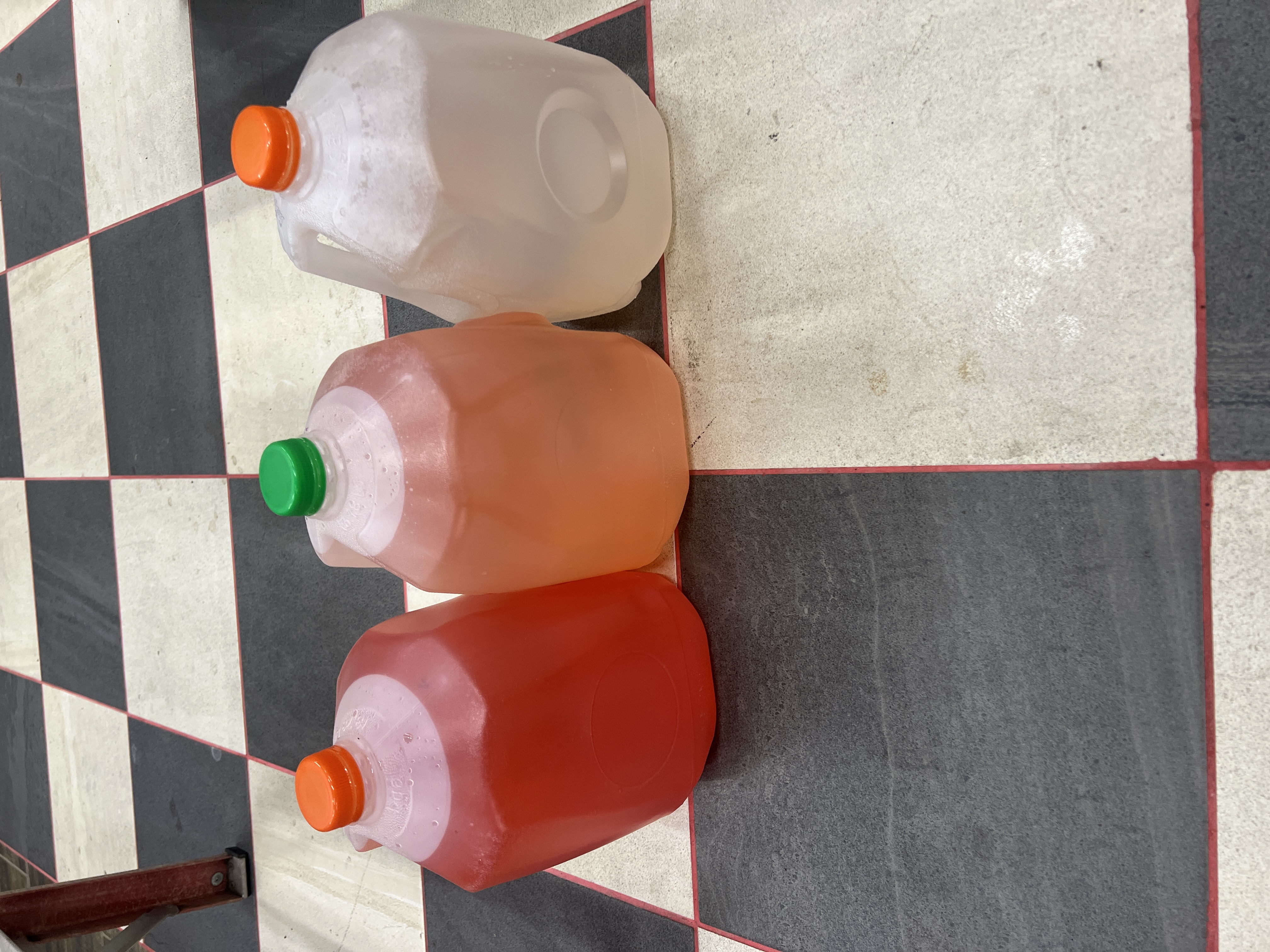

This is how I'm measuring progress today... I'm thinking another round or two and I'll be there...

That looks like various flavors of Gatorade for your car. Interesting view of drained and flushed fluids and I usually think I am thorough. Tom, you may have gotten the new OCCD crown, ha,ha ! Heh, nothing derogatory in that statement, I highly approve.

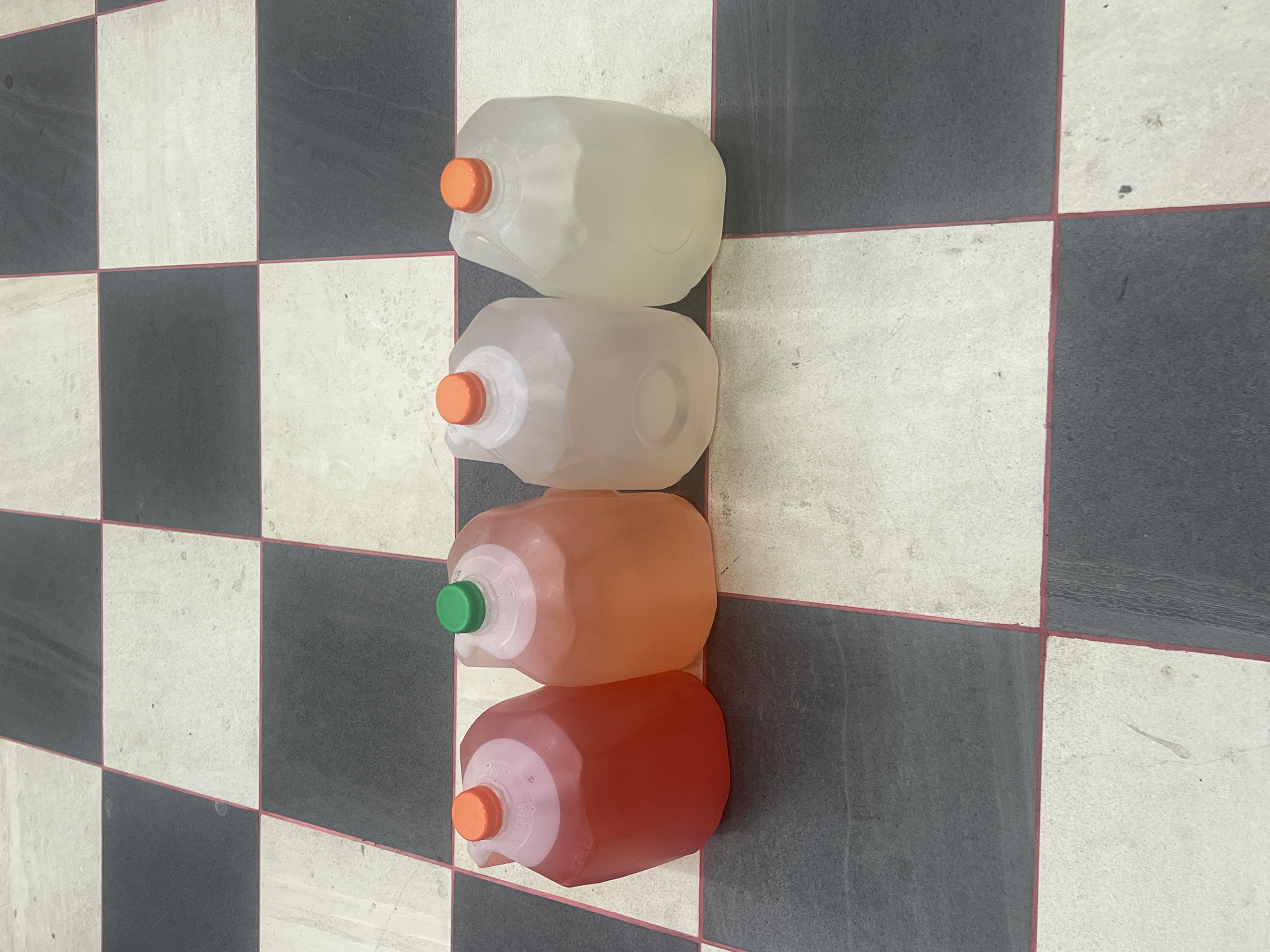

Singularity of purpose is my only super power. ;) Only one flush today, in between Clark Griswold house lighting duties. I filled it with distilled water one more time and will be curious if it changes at all vs the last flush. The last flush came out a very pail yellew/brown -- almost clear -- so I'm wondering if that's residual coolant or just the water getting 'dirty' in the block...

I did one more flush, but this time heat cycled it several times. Pretty sure now I'm just steam cleaning the block with all the Dexcool gone. I wasn't sure before when the flush came out slightly yellow, but by heat cycling several times the flush came out even darker yellow (i.e., the yellowing is coming from the cleaning action in the block, not old orange Dexcool). So, for prosperity's sake, I'd say two flushes with distilled water is good enough when changing coolant types, and three is clearly enough. One flush would not seem to be enough if you really want to get all the old coolant out....
