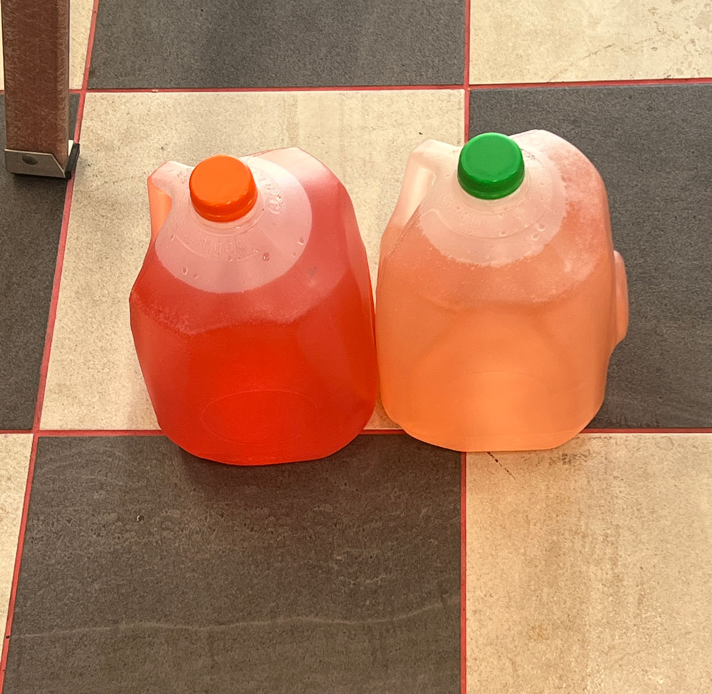

Thanks guys... Poking around a bit, I see a lot of people are using Dexcool in the 944 and 928, so 'lapse of judgment' may have been the wrong choice of words. But, there is/was some controversy about it corroding gaskets (whether valid or not, I don't really know) and -- importantly, neither Porsche nor any of the hardcore experts recommend it, so since I have my sleeves wet already anyway, I'm thinking I'll switch over to something Porsche endorses -- either G40 or G48. My new thermoswitch is in and the fans are working as designed again, and I have my first distilled water flush done. Kind of surprised how orange the fluid still is, and I'm now thinking it will take at least 3 rounds, maybe 4 or 5?, to see clear water coming out. I hate the idea of putting chemicals or even soap in there, so hopefully enough flushes with distilled water will do the trick. Depending on how well I can flush it, I'll either go with G48, which seems to be recommended by Porsche /GregB, etc., or I'll go with G40 since it seems to be an acceptable alternative per Porsche for the 944 and since it it supposed to react (gel) less with the Dexcool.
Used coolant on left. First round of all distilled water flush on the right. I'll keep at it until it would look at home in a snow globe.
p.s., jug-quality is not a trivial issue at all! I need the screw-on caps in order to have something to store the old coolant in, so I can dispose of it in a duck-friendly way...
