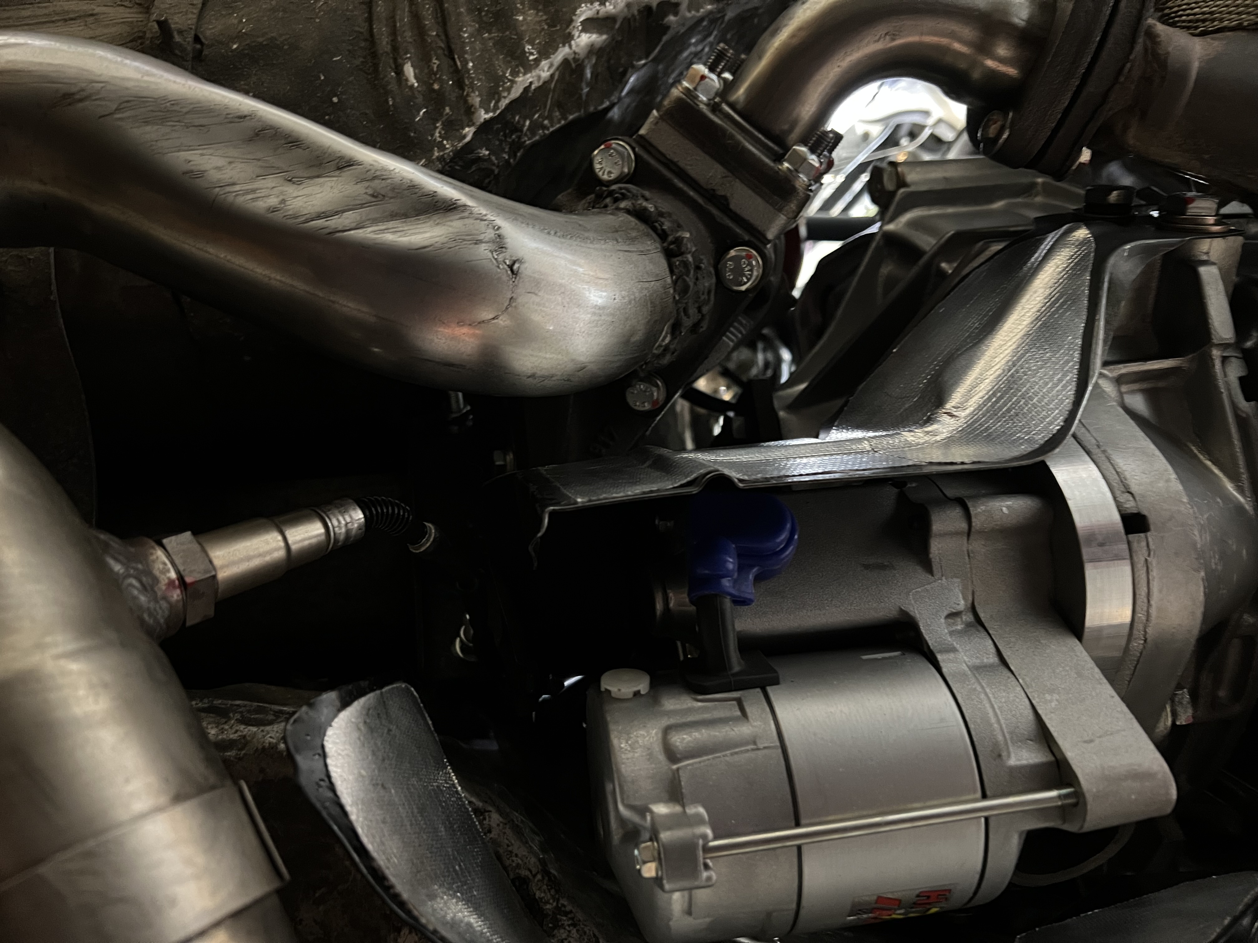

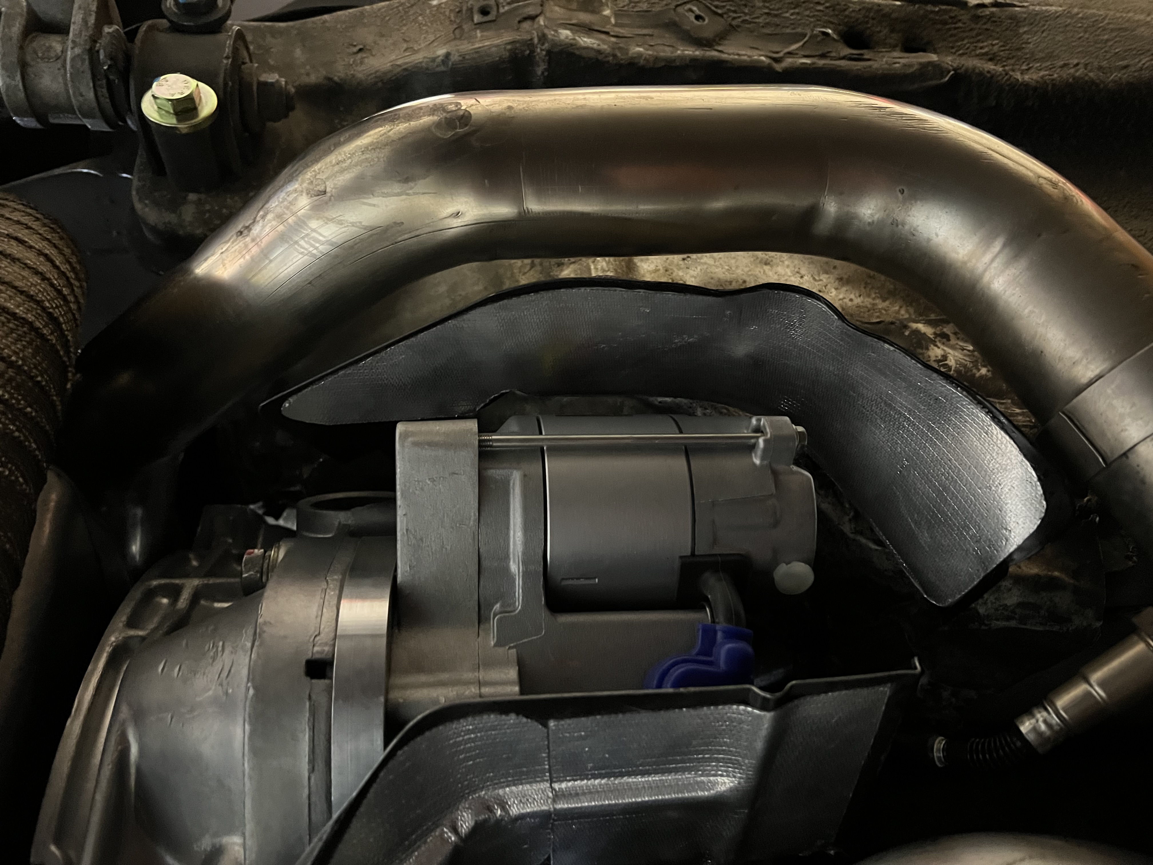

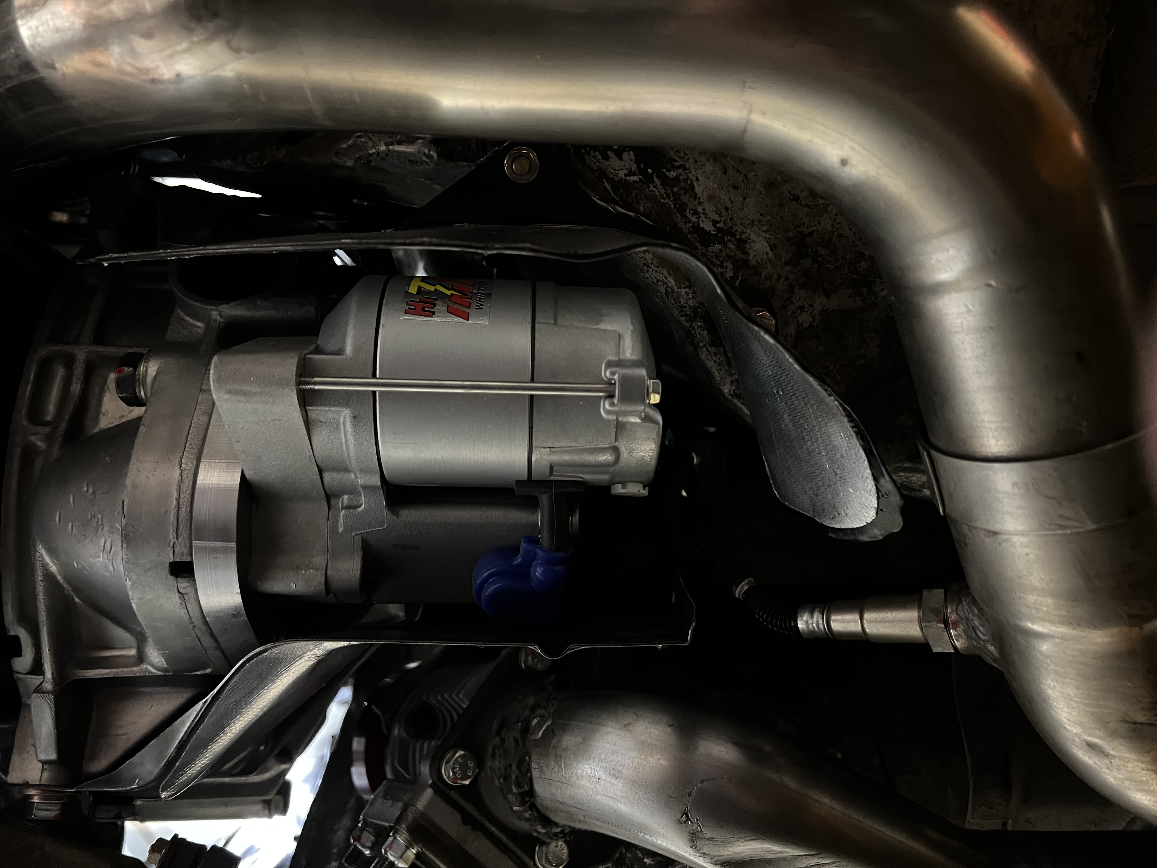

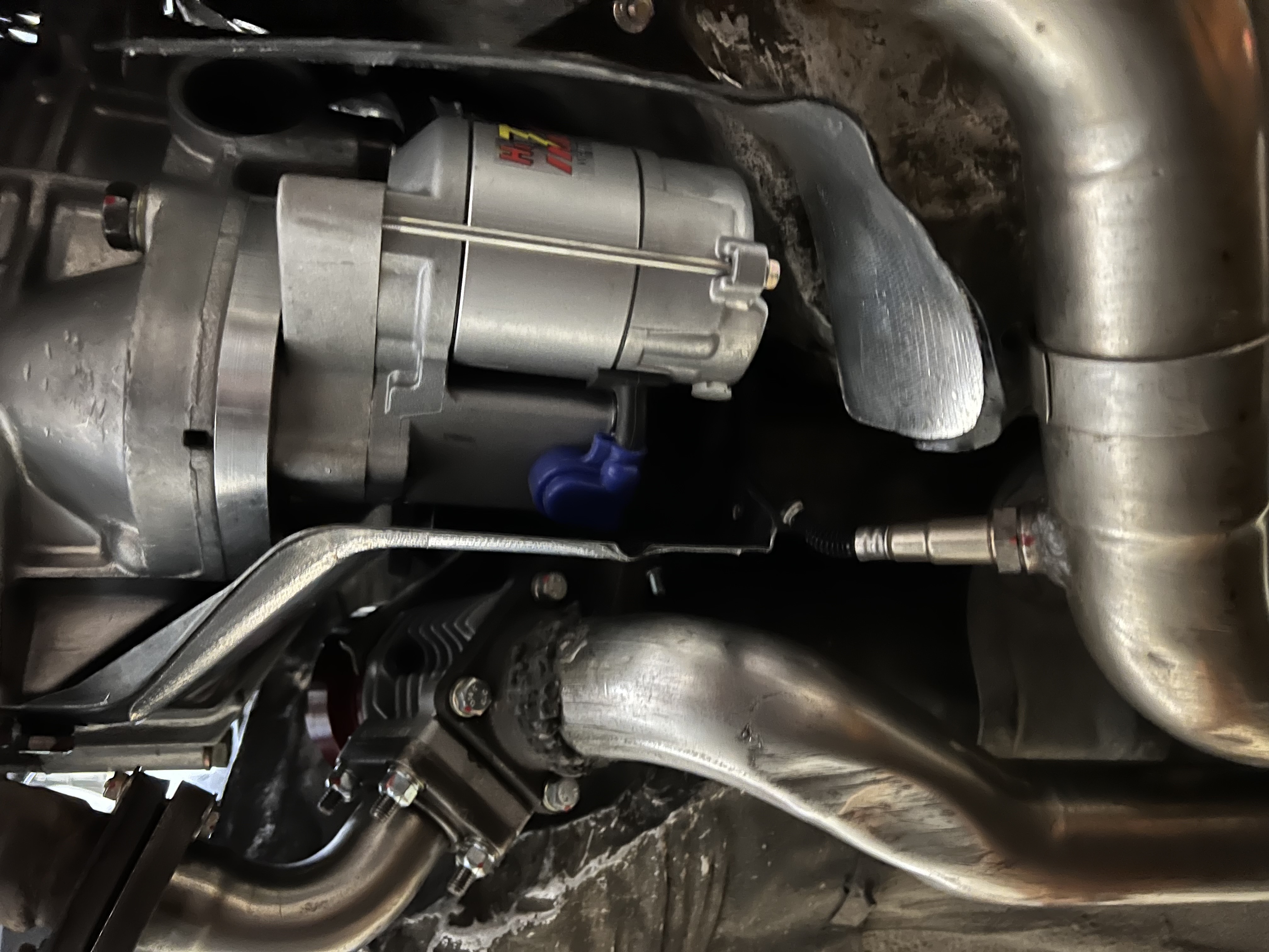

Here are some pictures of the Hi-Torque starter on a 1986 turbo. You can see from the side picture that the starter is well above the exhaust and even the stock heat shields. The Hi-Tourque starter is shorter than the original Bosch starter and one heat shield isn’t able to attach at the end of the starter, but it feels very solid and I do not expect any issues with it. Just getting this car on the road, but so far very happy with this starter.

Is that a modded OEM heat shield or did you custom fab that?

Good evening,
It is the original heat shield with an adhesive heat shield material attached to it. Trying to keep the starter as cool as I can.
