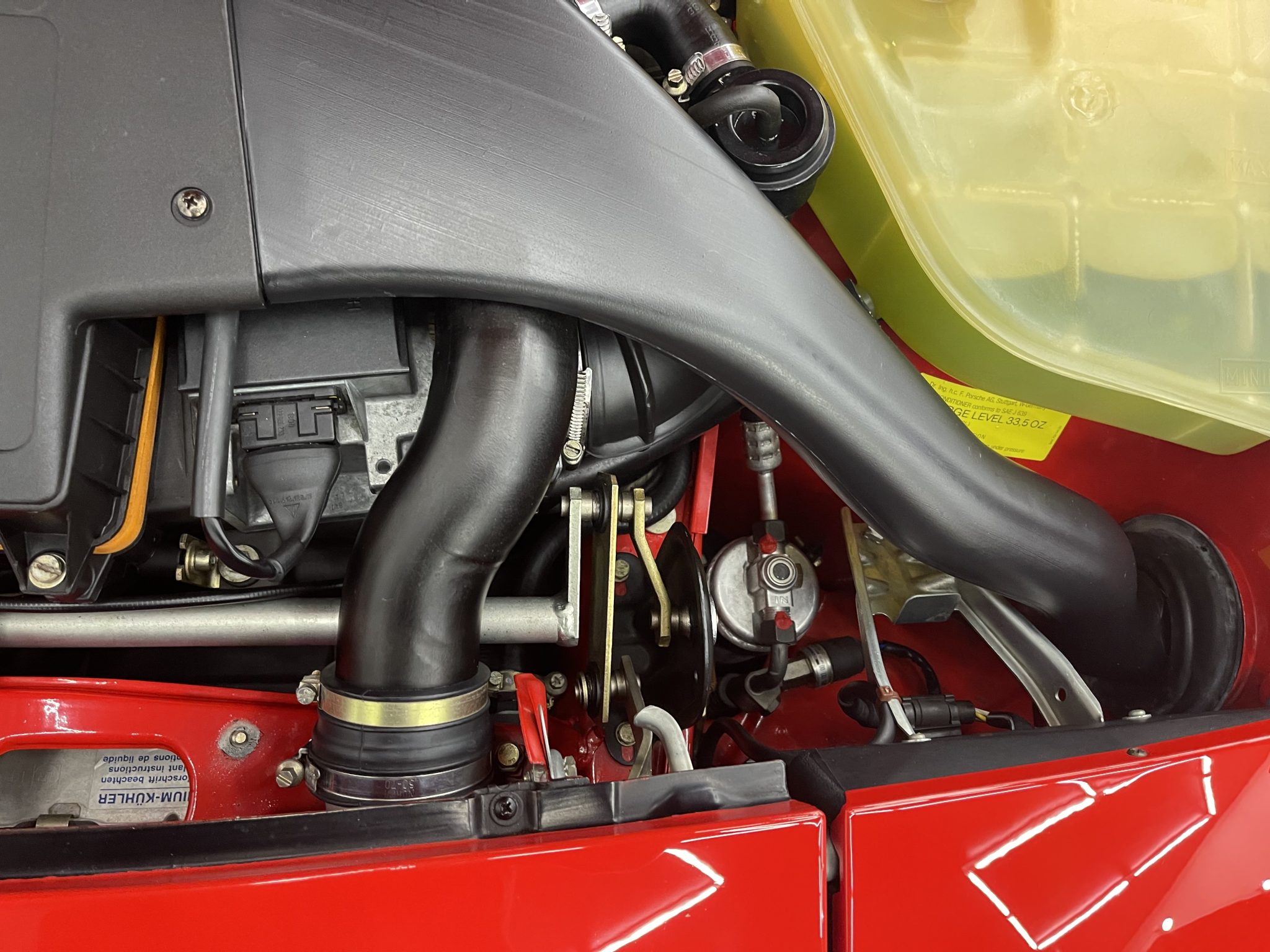

Regarding your AFM pvc sleeve dilemma...
I sometimes go to BAT and look at engine bay pics of very low mileage cars to get an idea of how some of the original wiring and vacuum line routes may have been done.
This is from a 3,100mile '89 Turbo.
Cheers
Cheers

Well my goodness. I can't believe I didn't think of that! For some reason, I just didn't think there was enough room between the top of the AFM and the airbox snorkel. I wonder if the factory put a plastic grommet somewhere on the AFM to hold the harness in place. I GREATLY appreciate you posting this!!!Gaspowered wrote: Thu Feb 05, 2026 10:38 am Regarding your AFM pvc sleeve dilemma...
I sometimes go to BAT and look at engine bay pics of very low mileage cars to get an idea of how some of the original wiring and vacuum line routes may have been originally done.
