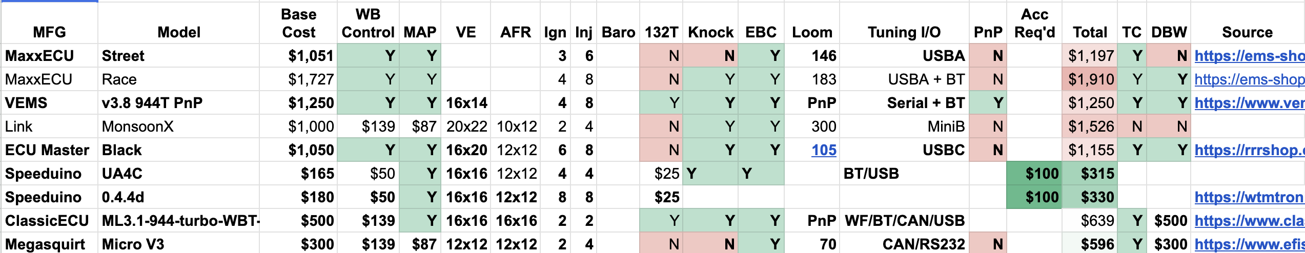

With that in mind, I evaluated every ECU I could find. From this analysis, the ECUMaster Black bubbled to the top for its features (IP67, built-in WB control, MAP control, and knock) and price point (esp. considering loom pricing which would justify an adapter loom at first, and a full rewire down the road), but still wasn’t plug and play, and sourcing male headers for both Motronic connectors was proving challenging.
Screenshot 2026-03-08 at 7.02.43 PM.png (287.94 KiB) Viewed 684 times

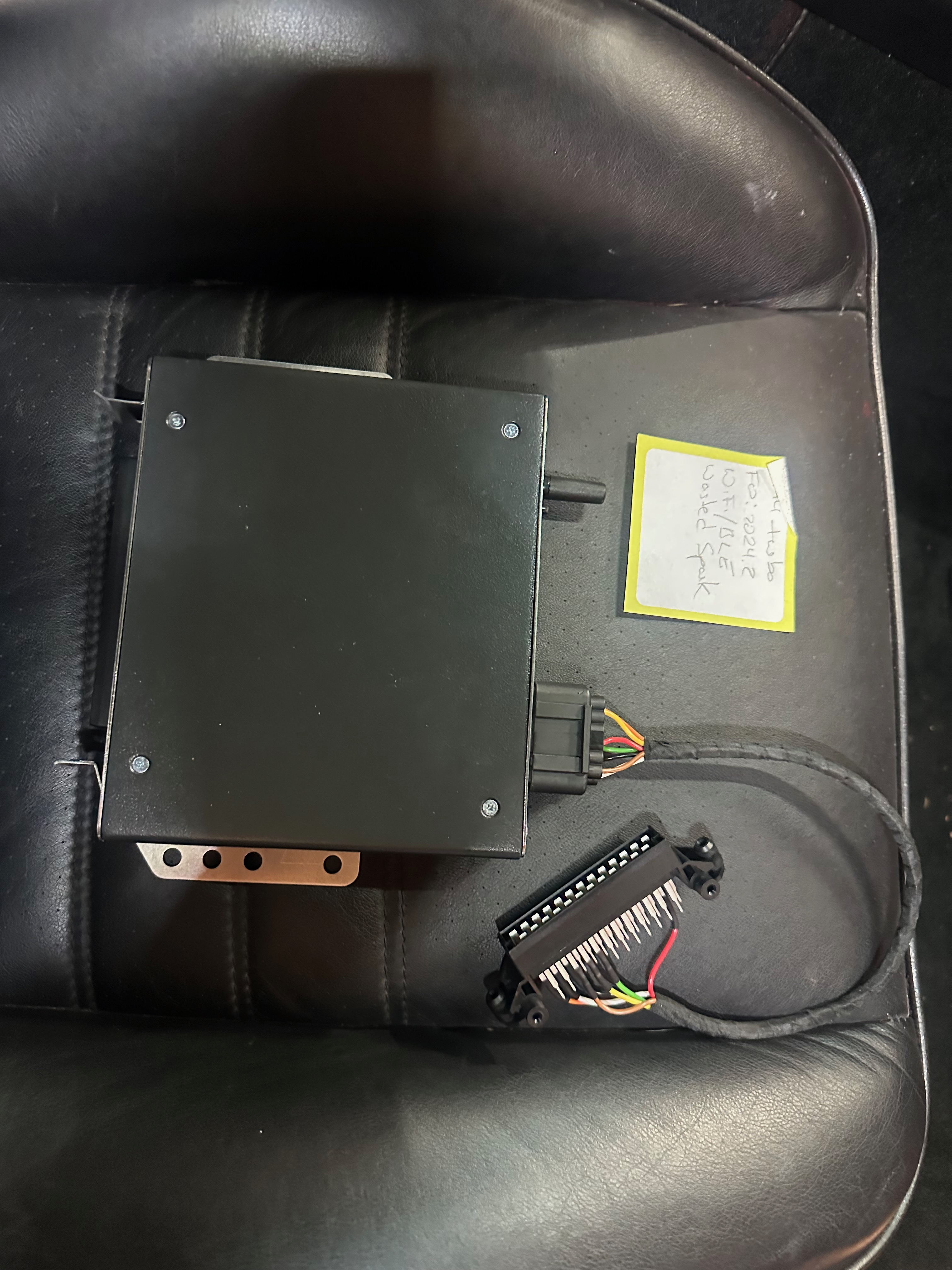

Then I dove into Speeduino, starting contemplating printing my own breakout or daughter boards, and stumbled across ClassicECU who had already done exactly that, including the built in VR to use the stock speed and position sensors and 132T wheel. I got in touch with Dirk at ClassicECU and he was super responsive - AND it turned out I would be the first 951 customer, so could help him develop the base tune for our cars. That sounded like unnecessary fun, which is my favorite kind, and another opportunity for me to learn more about my car and tuning.

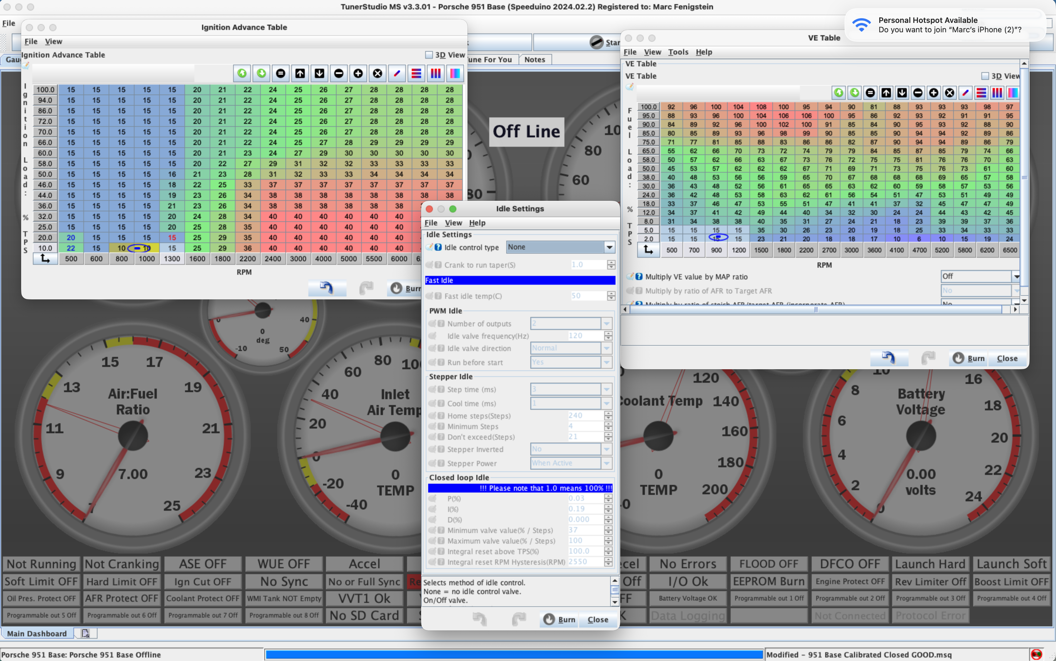

2. Finally, start the car - it idled high but ran well enough to get it to operating temp (>85C)
3. I *then* went through an idle tuning sequence without idle controls as recommended in this YT video
  • Warm engine up to operating temp with base settings.
  • Turn off Idle Control in Startup/Idle Settings
  • Turn off EGO Control in Fuel Settings by reducing Controller authority from 10 to 0
  • Set VE table in Idle area to single figure (used 30 at first, base tune was in the 50s!!)
  • Set ignition advance to 10 degrees at (and just above) idle, with up to 5 degrees more (15deg total) below target idle.
Screenshot 2026-03-07 at 10.21.35 PM.png (387.1 KiB) Viewed 676 times

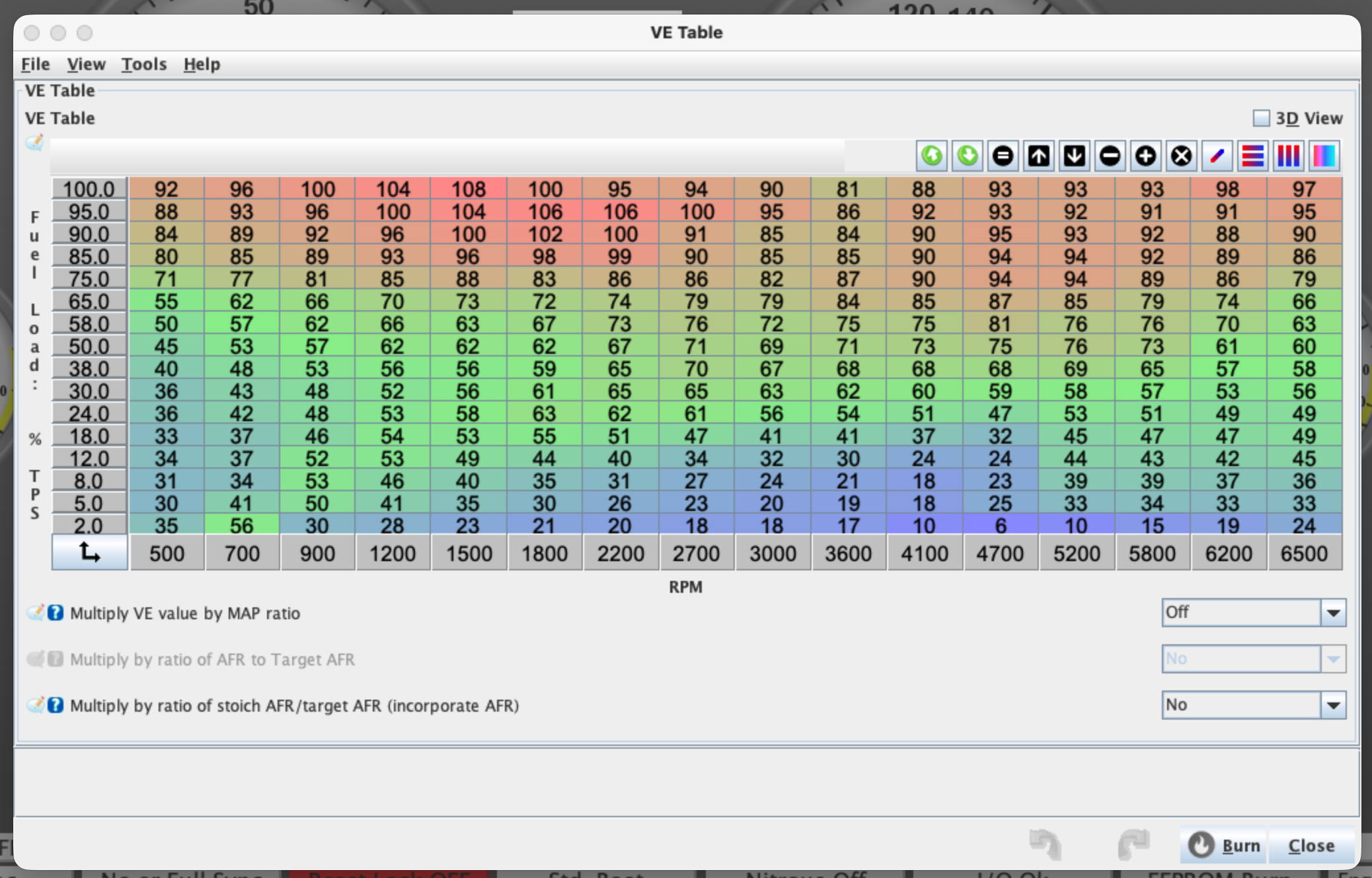

4. Thanks to this extra step, I discovered the car naturally idled too low and my throttle body idle needed adjustment to open up a little more. I suspect the last time it had been set, I had a small vacuum leak that I since addressed. This gave me a stable idle ~800RPM at operating temp with no idle controls from the ECU.
5. Second discovery was that the fueling in the base tune was extremely rich at 50, I started at 30 and ended up landing on 15, which also allowed me to close the idle screw at the throttle a touch more, while still maintaining a smooth 800rpm at temp. My actual target is 850RPM, but I wanted the base setting a touch lower so the idle controls could actively manage it
Base:
Screenshot 2026-03-07 at 10.10.39 PM.png (818.83 KiB) Viewed 676 times
Adjusted:
Screenshot 2026-03-08 at 2.09.49 PM.png (2.68 MiB) Viewed 676 times

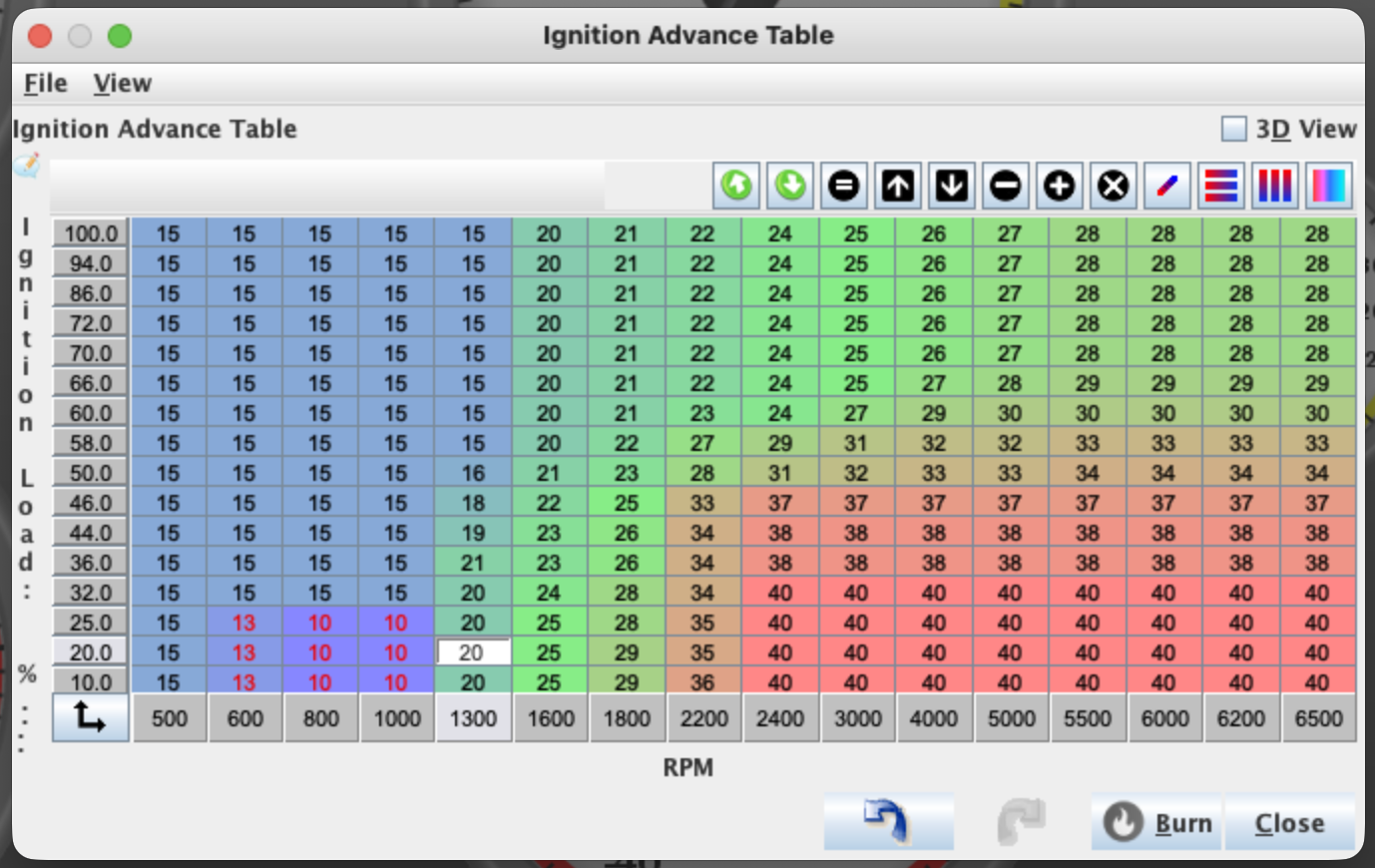

6. Third change is that I lowered the ignition advance in the idle range significantly from base settings. Using the stock DME settings as reference, and based on some Microsquirt tunes, I started at 10 degrees of advance at idle.
  • this approach also allowed me to tune more of the idle advance into the base ignition map, and rely less on the closed loop idle advance controls.

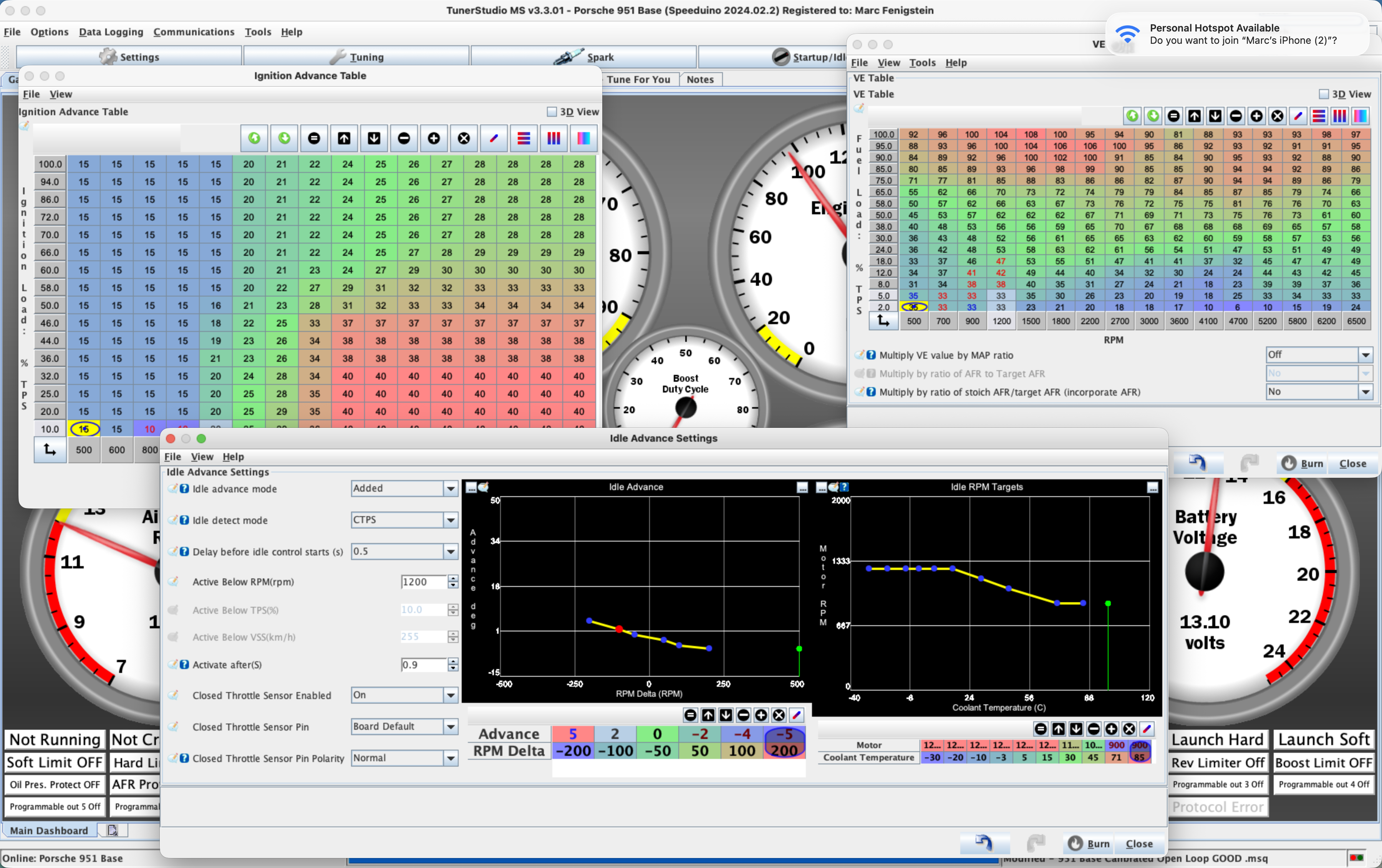

Confident in my base idle settings, I then turned on Closed Loop Control. The car seemed to run well, however:
  • the car was warm so I wasn't able to test how well it tracks during warmup
  • the idle advance table seemed to be running backwards in Tunerstudio. I know that sounds bizarre, but when the engine was running over target (e.g. 950rpm), Tunerstudio was calling that negative delta (i.e. "-100") and calling for more advance (e.g. "+2 degrees). You can see in this example image below, with the car at 0RPM, the idle advance is looking up the +200 and calling for -5 degrees of advance.
Screenshot 2026-03-08 at 1.48.33 PM.png (2.52 MiB) Viewed 672 times
  • because I was not confident in my interpretation of the table, I decided to stop with tuning for the day.
Can someone walk me through the idle advance table? Every curve I've seen for this table is from the upper left to lower right, with positive advance values for negative RPM delta values, but when I ran that on my car negative RPM delta was when it was running fast, and that makes it seem like it was ADDING advance when running fast which is the opposite of what I want. :wtf:
