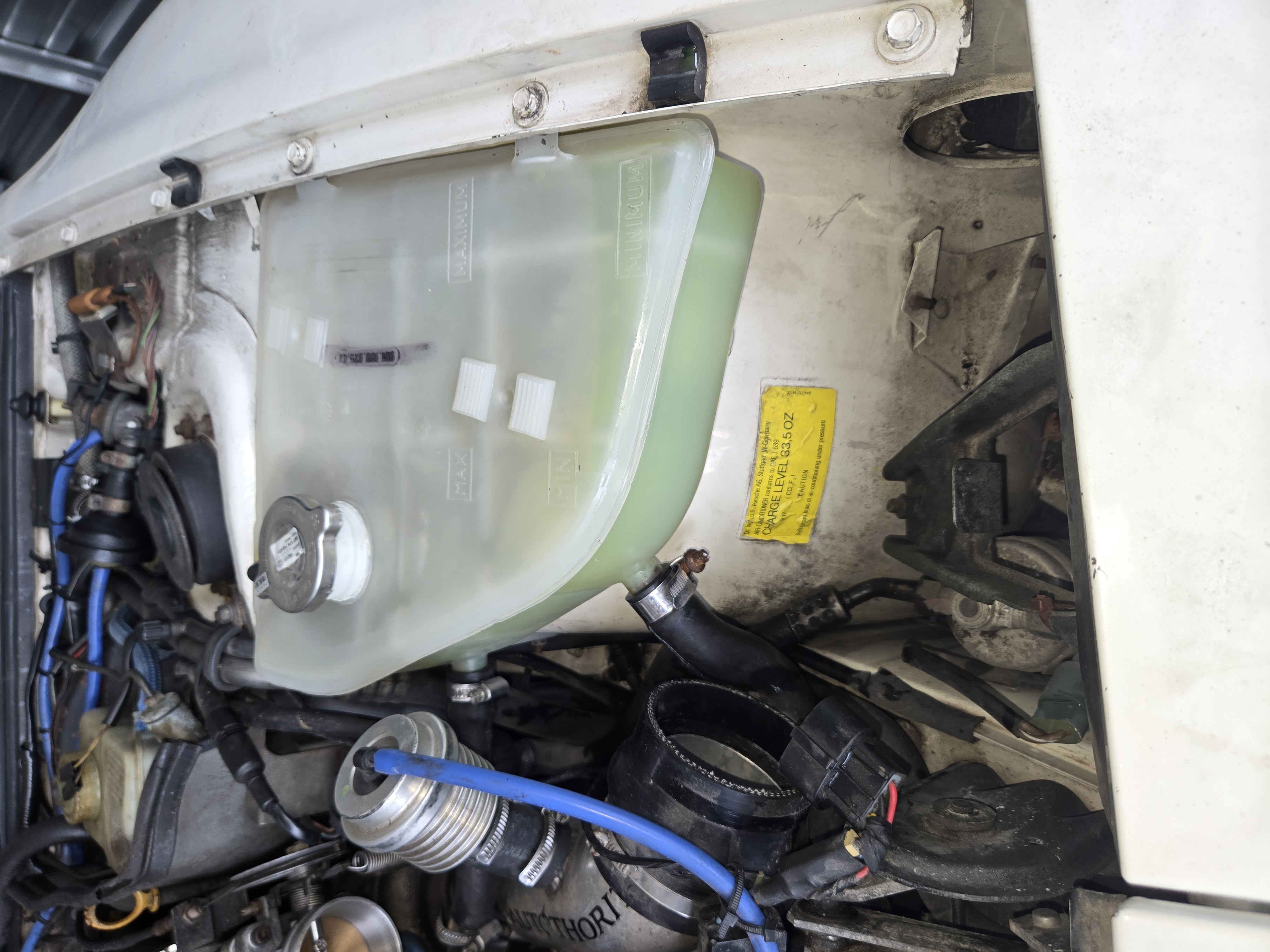

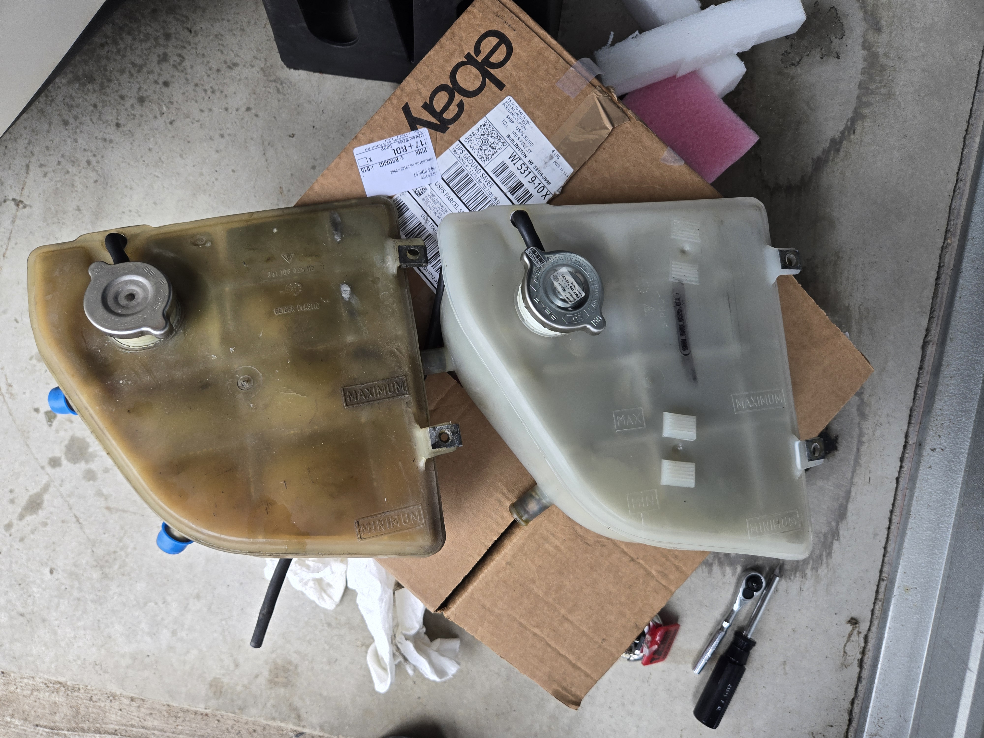

I haven't been able to spend much time on the car lately due to my work schedule.
However, I did find a used coolant reservoir at a price that I couldn't pass up, and it was worth every penny!
Now the coolant level is clearly visible; no more guess work.
I will still bleed the system through the vent bolt and cycle the HVAC system to get air out of the heat exchanger etc. I do plan to invest in a pressure tester also at some point.

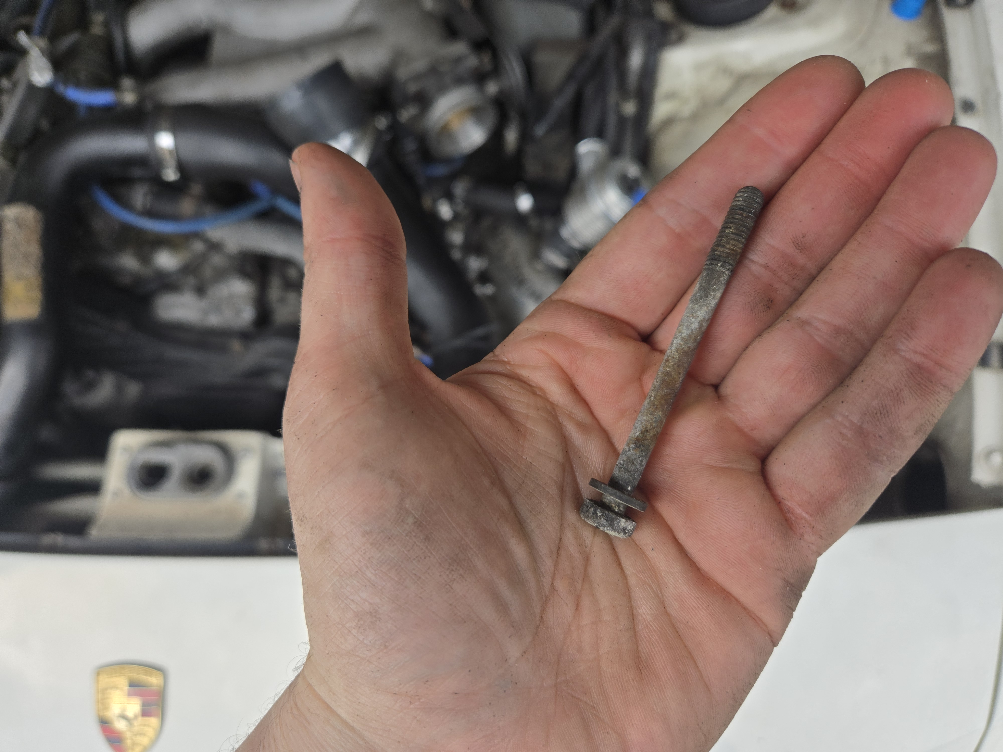

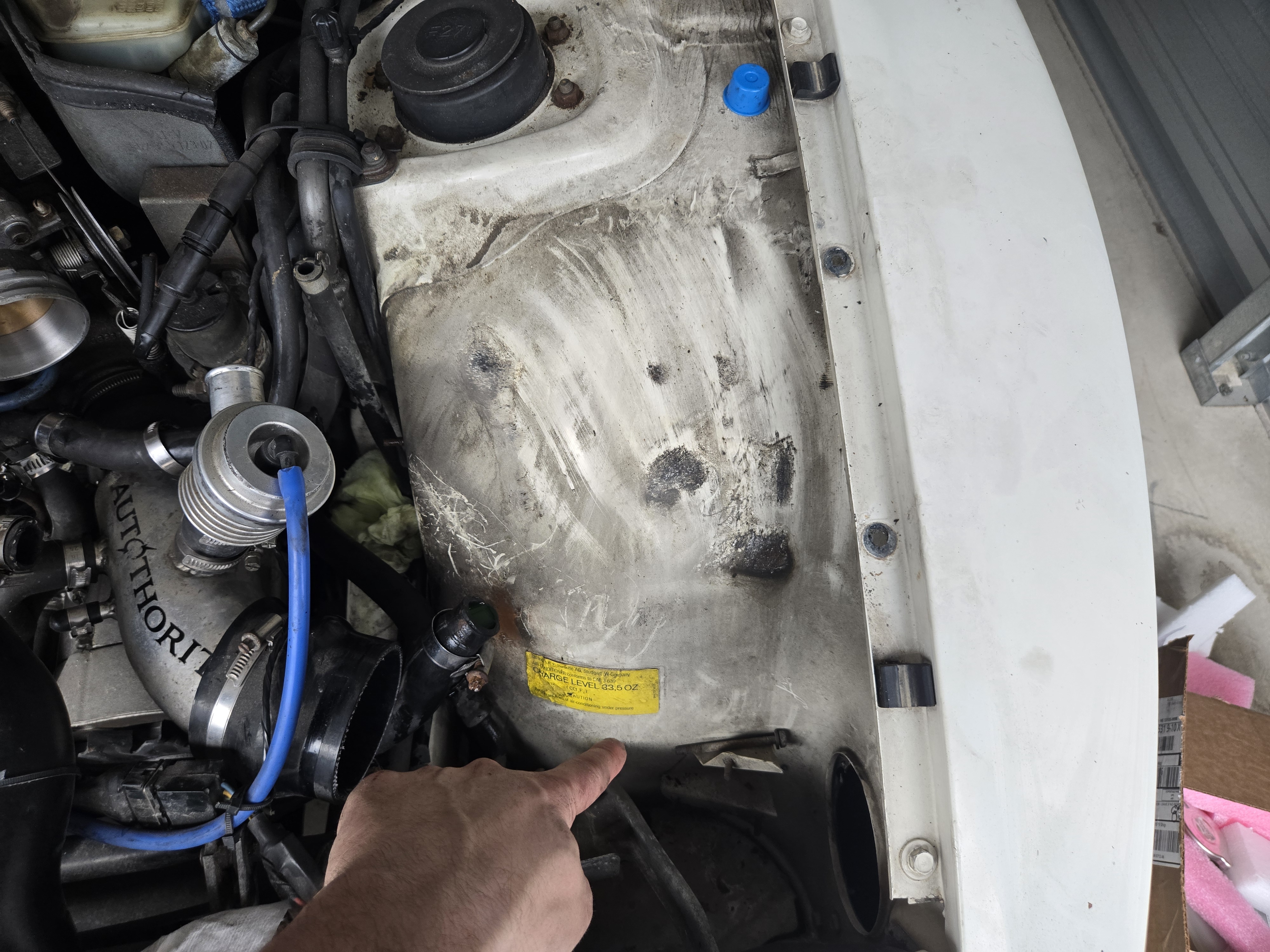

What are you pointing at?

danmartinic wrote: Wed Apr 15, 2026 1:24 pm What are you pointing at?
When I removed the coolant reservoir, I found a loose bolt in the engine bay. I don't know where it came from or how long it's been rattling around in there.
Hopefully it's not for something important. :think:

I'm game
One of the bolts that attached the original AFM to the original air cleaner housing

My guess is one of the bolts for the water pump. If we win, do we get your old coolant tank as a prize?!
