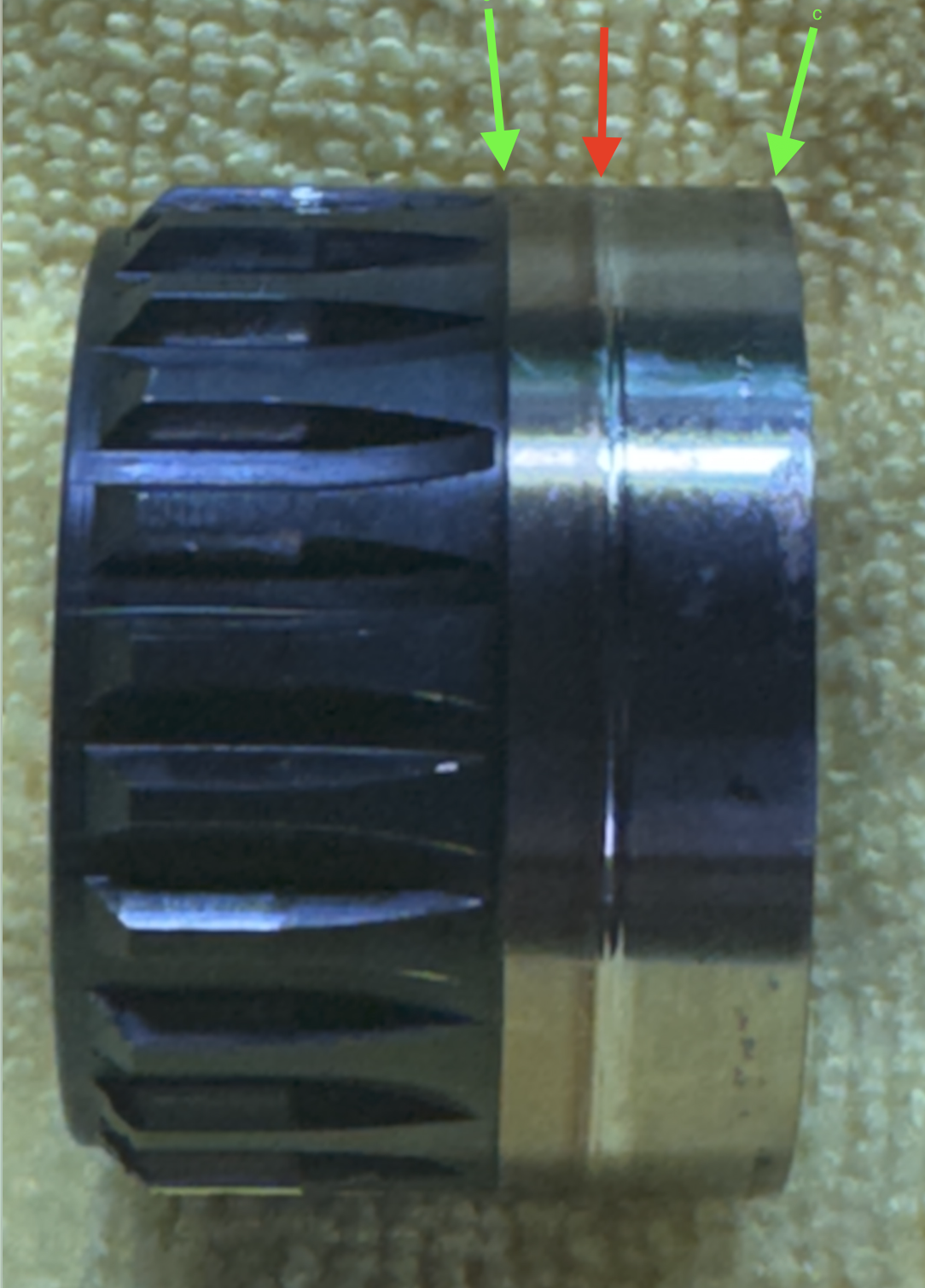

I know that I should replace this if you can feel any groves with your finger nail. Should it be smooth from green arrow to green arrow or red to green arrow? On mine I can feel a grove right around the red arrow. From the records I have I don't see where that gear was ever changed at any of the previous timing belt changes so I believe this gear has 134k miles on it.

Yes, that oil pump drive sleeve is bad. The groove (red arrow) is caused by friction from the lip seal and many miles.
