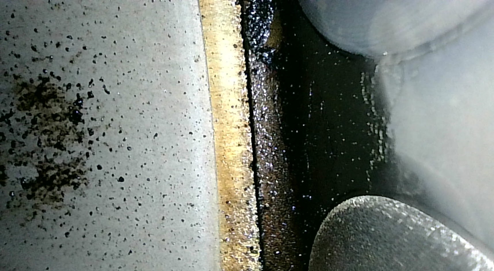

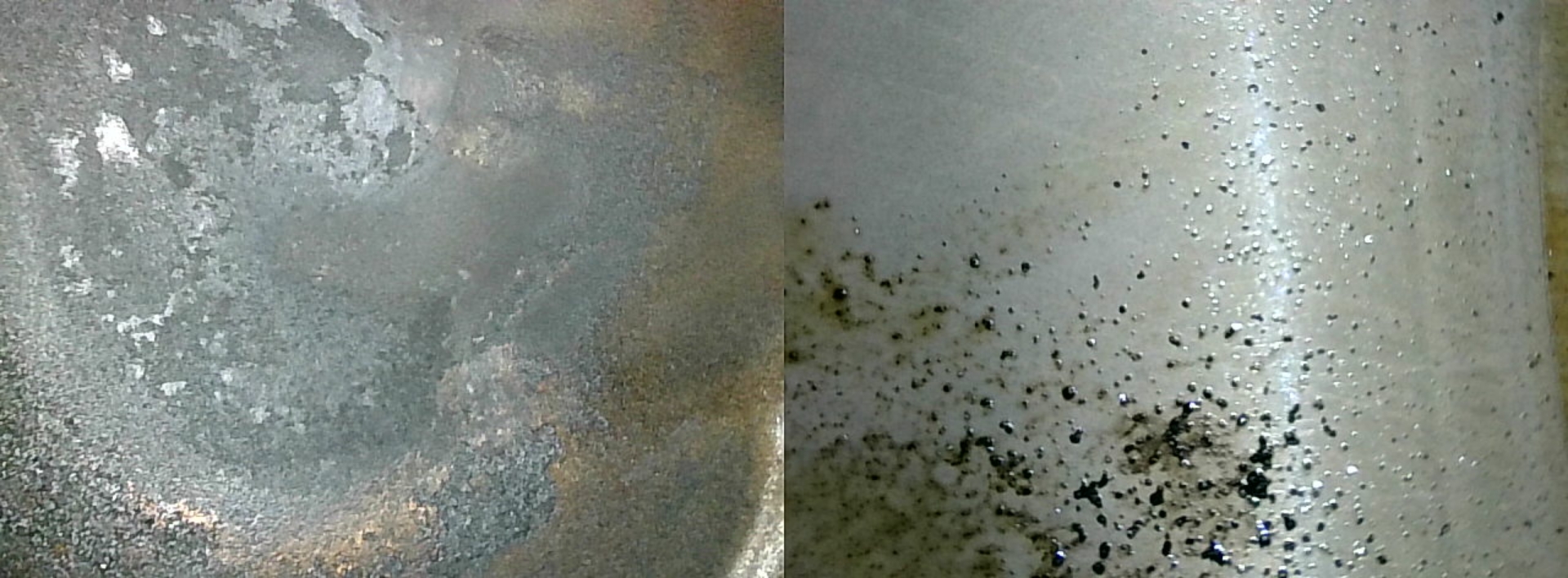

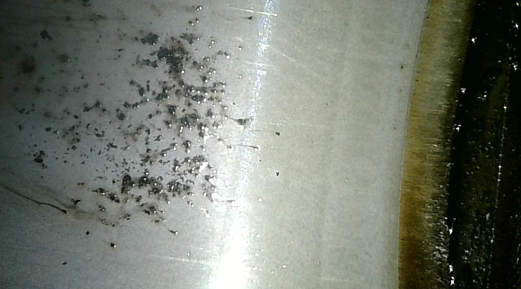

That said I've managed to find something very weird looking. It looks like carbon debris to me, not sure if there is any actual scoring here. After taking a few pics of this I reached a rubber hose down and blew compressed air in, and then took more pics, and the debris was spread around so it's definitley loose and not something that's permanently stuck to the cyilnder wall.
What am I looking at here? Is this causing the noise?
It looks to me like the carbon build up from the top of the piston and the cylinder head is coming off on the wall. Still it's hard to imagine this making that much noise. But I haven't look at the other cylinders yet.

Maybe just crude dislodged when you pulled the spark plug? If compressed air moved it around, it would almost certainly be swept away when the engine runs...?
