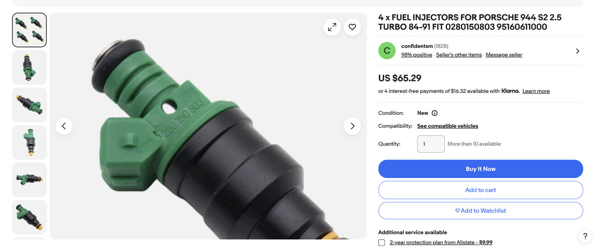

Welcome aboard -- great to have you. As George said, based on the resistance readings, assuming they are accurate, you may very well have cheap knock off injectors. Check out this set on eBay right now -- green top, stamped with same part number and basically 'look' like 944 turbo injectors, but at $16 a piece brand new, I'd bet the farm they are fake. The connectors may be ill-formed too, explaining the loose connectors. Maybe post some close up pics of your injectors (and weigh them if you have a postage scale or something to weigh them on -- a lot of knock-offs are lighter than the real ones.) Honestly, I'd hold off on doing anything until you get to the bottom of the injectors. My hunch is these injectors are the root of your rough engine and loose connectors.

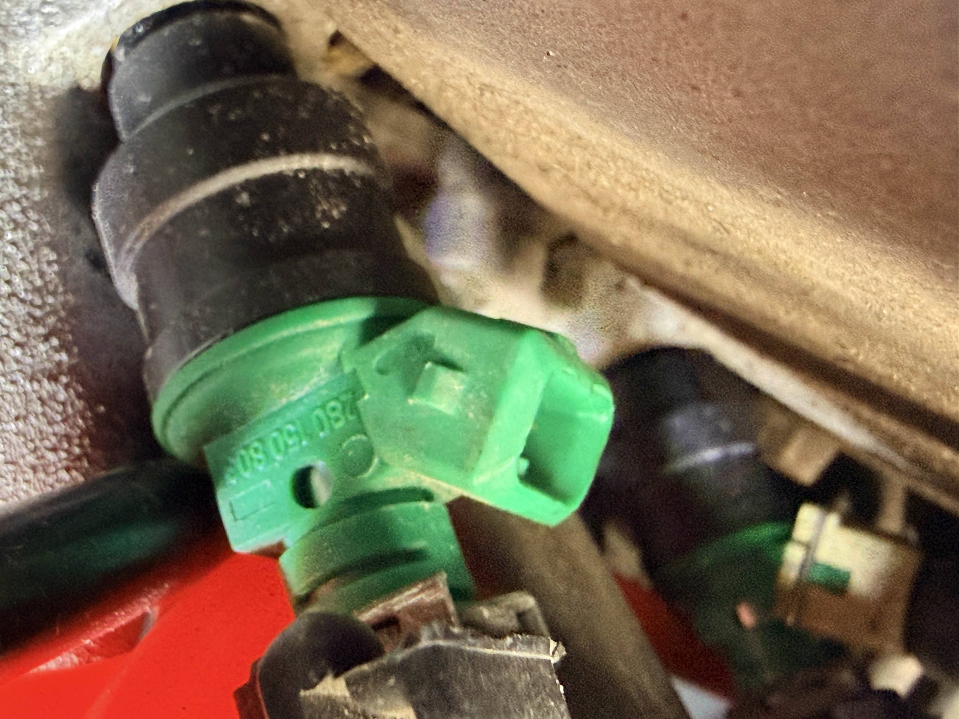

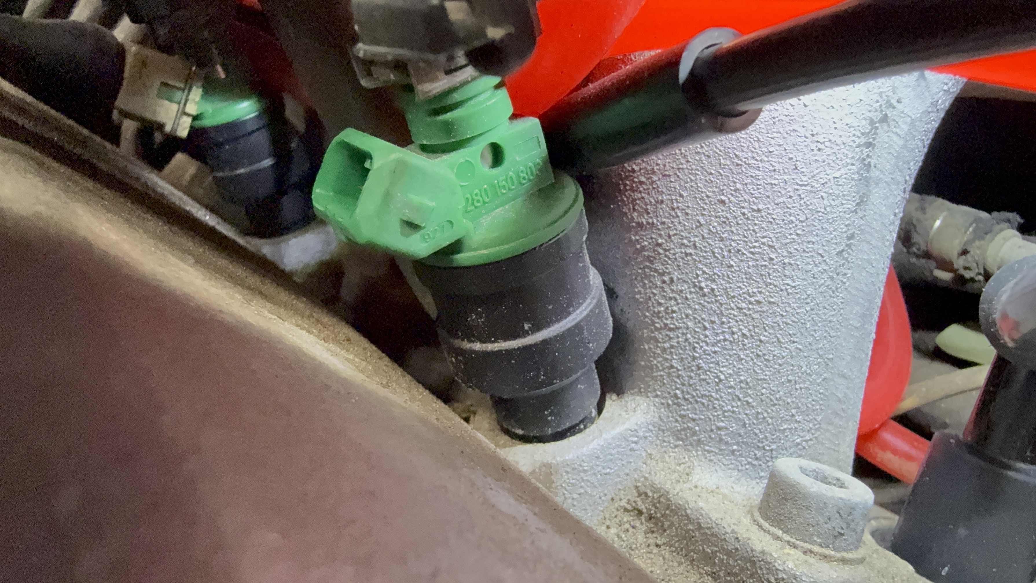

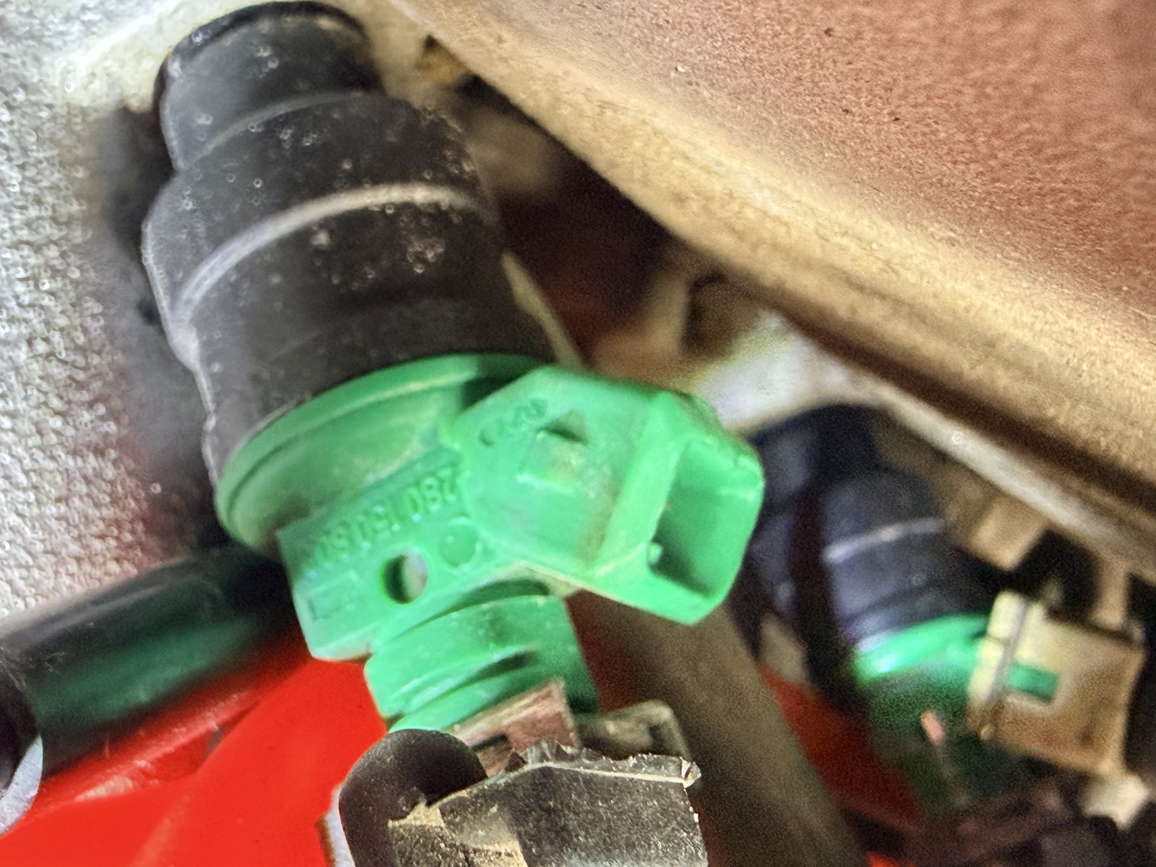

I appreciate the response. Yep I would be willing to bet those are likely the same cheapo injectors. I took a couple of pics and also a video showing how flimsy the OEM connectors fit. I had a spare NA injector laying around and those connectors fit just fine and snug. The injectors are still in the car so I can’t weight them but I will try to pull them soon.

Hard to be 100% sure, but I'm thinking those are cheap fakes. Not very scientific but the bright green looks cheap and plasticy compared to the real ones -- much lighter/brighter green too. Also note the lack of Bosch logo and batch numbers in the little stampings pointed out in the original below. And the connectors don't fit right. All of that 'could' be just changes made by Bosch over the years (everyone seems to be making parts cheaper these days), but the kicker is the 14.4 ohm resistance reading. If you double checked that and they all read that high, I'd say there's clear and convincing evidence they are fake.
