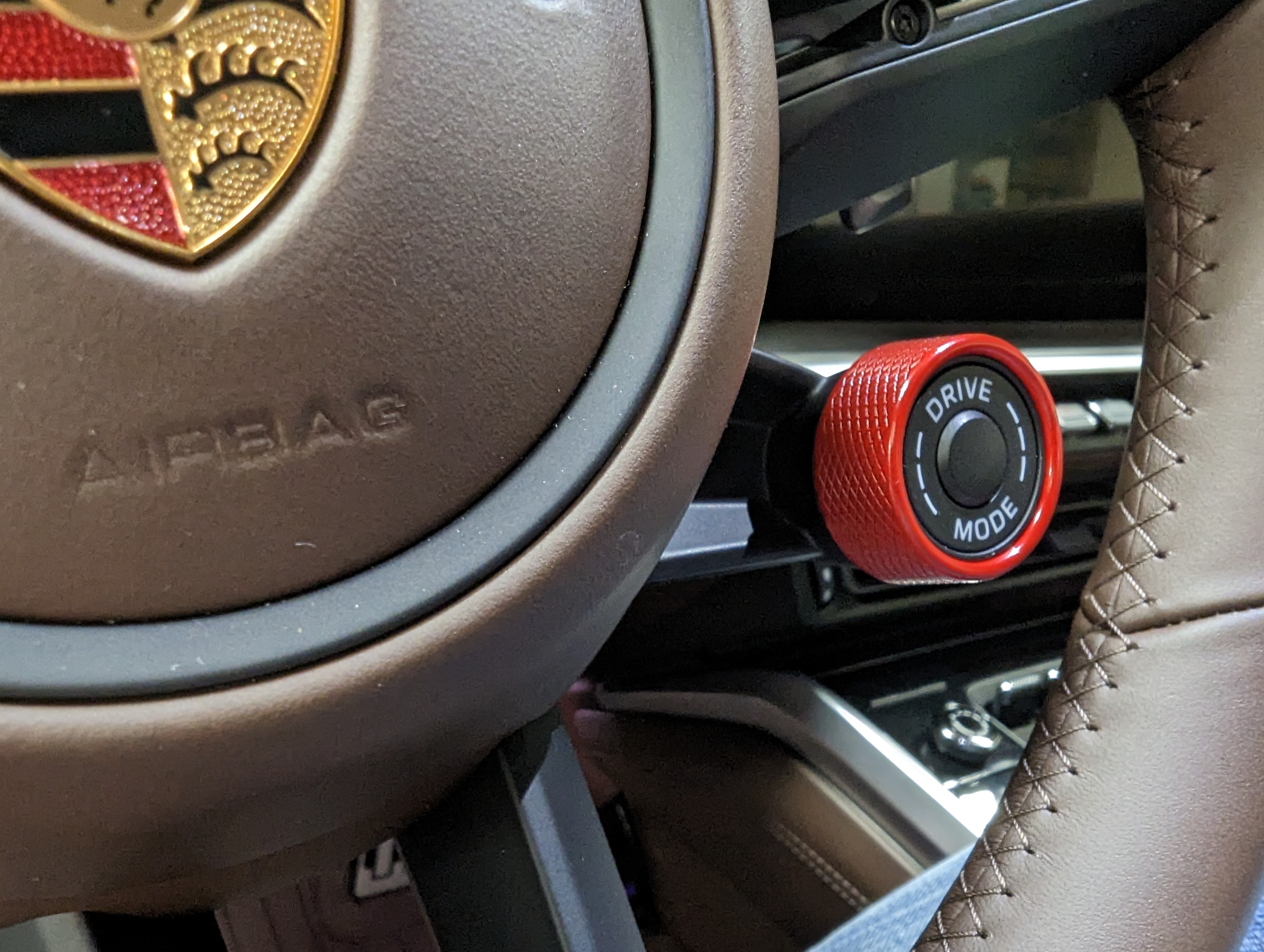

It's easy to twist the dial one notch - especially so now that I have the Carpokes dial mode cover!
